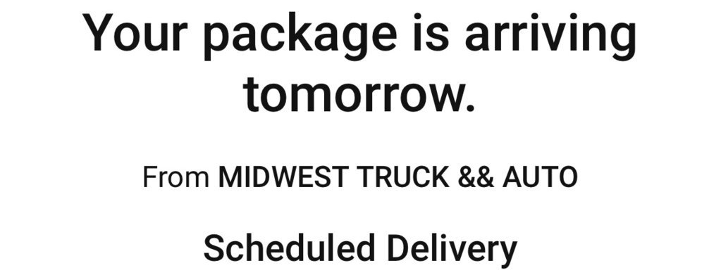

    They’re coming directly from Midwest truck. Does that seal the deal on being legit then? Shipping from Indiana which matches their website for their address.
