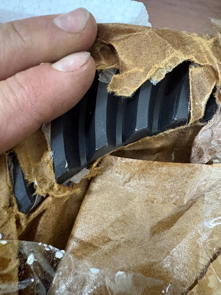

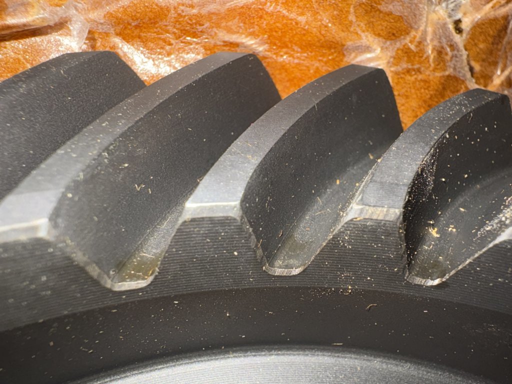

  30. Nov 25, 2024 at 11:31 AM
    #360
    kbahus
    kbahus New Member
    Dec 6, 2023
    #108056
    205
    MI
    2015 MGM Tundra Limited Crewmax
    Well crap, gears came in but the rear ring gear has some minor damage. The styrofoam insert and ring gear was upside down in the box so it was subject to impact. Thinking I should probably return this one and get a different one, any thoughts from the pros? Not sure if the dings will cause any problems with wear or not.
