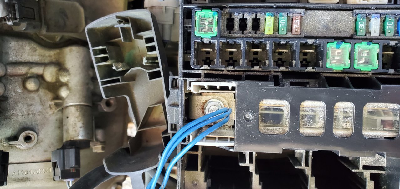

    Hello everyone, glad to be a part of a ever growing family of Sweet Trucks!
    I just purchased a 2017 1794 edition Tundra crew max.
    Has lots of bells an whistles....
    My concern after looking over at home, is I found some extra wires... coming from fuse/relay box to battery directly.
    I asked a fellow Tundra buddy, but we couldn't find any extra or added items that would cause these wires.
    It goes from POSITIVE battery to main fuse on relay/fuse box. Like it's a jumper20220630_153259.jpg

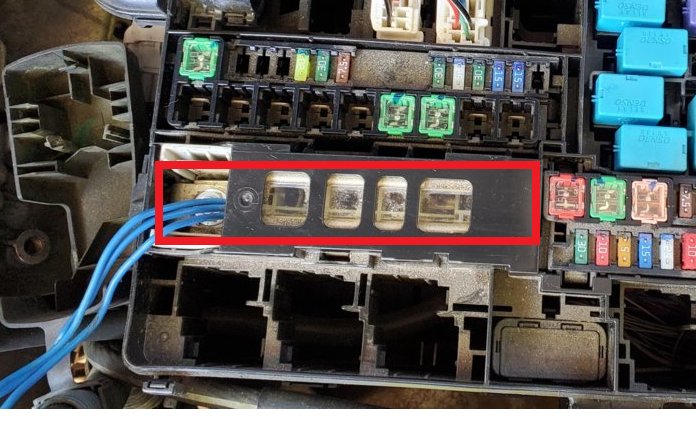

    27
    Josh
    2017 1794 Tundra
    Here is another picture for refrence...

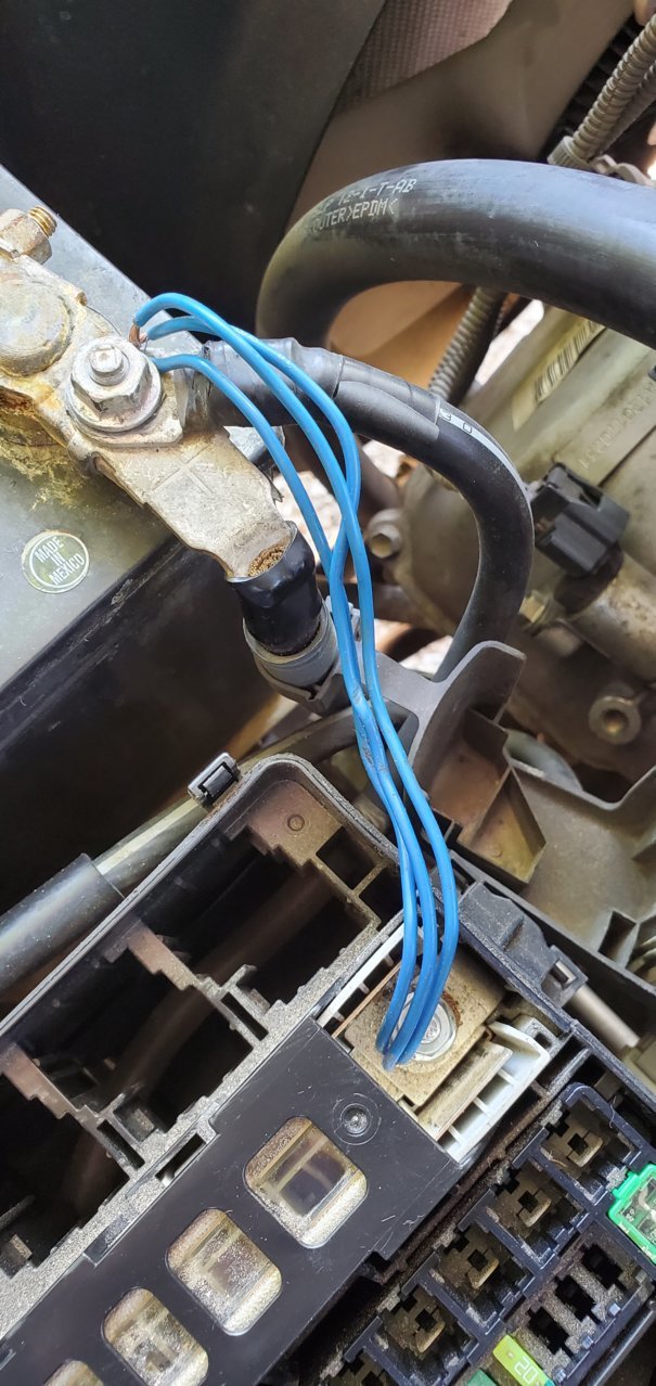

    Interesting. Can you post an overall shot of it connecting to your battery? I want to see the cables and terminals that are on your battery.

    That is interesting as hell. I don't see why that would be there. @RainMan_PNW and @Jeff_5_7 have you guys ever seen this?

    I guess you could call the “Little 3” upgrade. (Big 3 upgrade is where you replace the three main cables with larger to better handle added loads like big audio systems, high output alternators, winches…)
    Those three are just paralleling the existing 4ga ?? cable from the battery box the the fuse box and are useless. Remove them ASAP. Any issue with your main power cable and they will be glowing elements.

    Definitely looks like jumper wires from the battery post to the main power inlet of the fuse box. It just essentially "bypasses" the factory cable from the battery to the fuse box.
    My only thought is one of the terminals on the factory power cable was/is loose or dirty and wasn't making a good clean connection. I say this because it looks like sand or dirt around your fuse box area. Rather than fix it right they just added in some jumper wires in a very poor way.
    I would remove them, high loads of electricity flowing through here and if they melt of short out you will have big problems. IF you remove them and have power issues, the main cable from battery to fuse box may need to be cleaned or replaced. These definitely looks like an attempt at a quick fix for that.

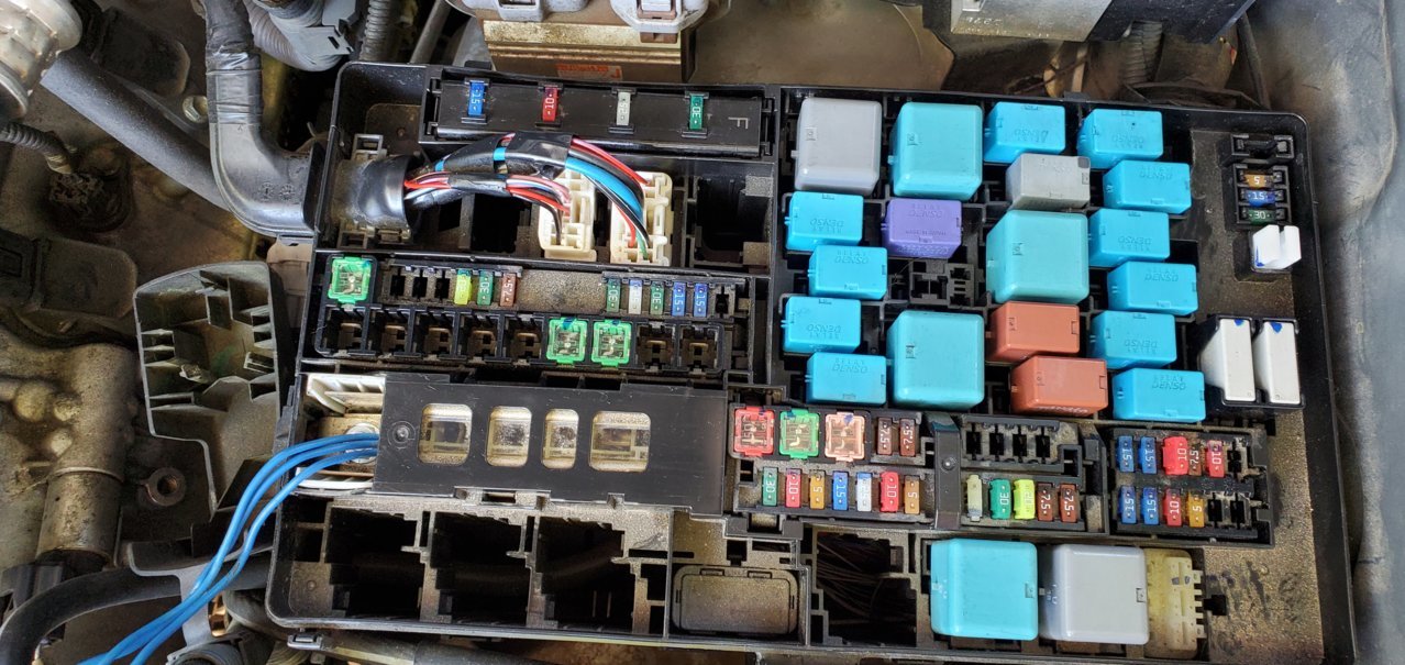

    A good overall of the fuse box, need to see if anything else visibly is wrong. I am looking at power source to interior dash components now. Something was being bypassed
    HKTAT2S[QUOTED][OP] likes this.

    Here maybe

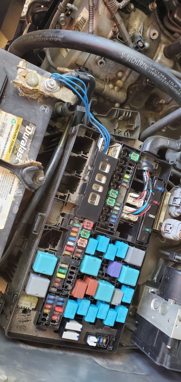

    Another

    Hypothesis:
    Those three wires are coming from the positive battery terminal to bypass the fusible link.

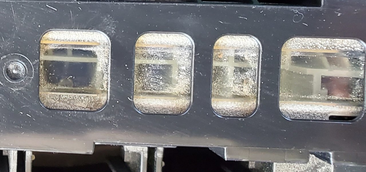

    Looking now but I tend to agree, part of the fusible link is most likely blown and the jumper wires are bypassing that. Looking to see if that makes sense with the truck running but most of the interior being dead power wise.
    Can you look in the clear windows of the fusible link and see any black, burning, dirt, damage? Post a higher quality photo of this area.

    Would these work its hard to tell

    I can't remember if that exposed bolt is where the lead from the positive terminal attaches to or is the fused output. I can't go out to the truck and check right now.
    If it is the input side, it's possible that the battery cable is broken and they took the easy way out.
