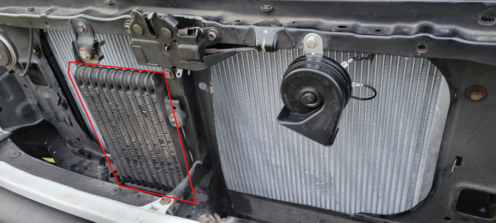

    Yes but many Tundras already have an "auxiliary" cooler in front of the radiator as standard equipment in addition to the rad "cooler" as seen in this pic

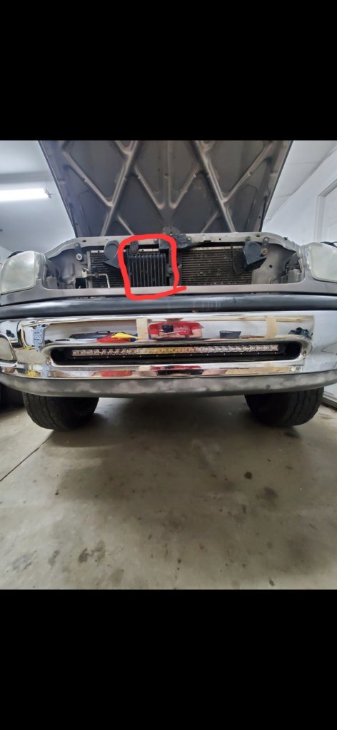

    I've been running the external cooler exclusively for a couple years (the Radiator connections were disconnected when I got the truck).
    I live in MI. Not saying it's ideal because the trans does not get the benefit of the Rad warming the fluid on those cold days.

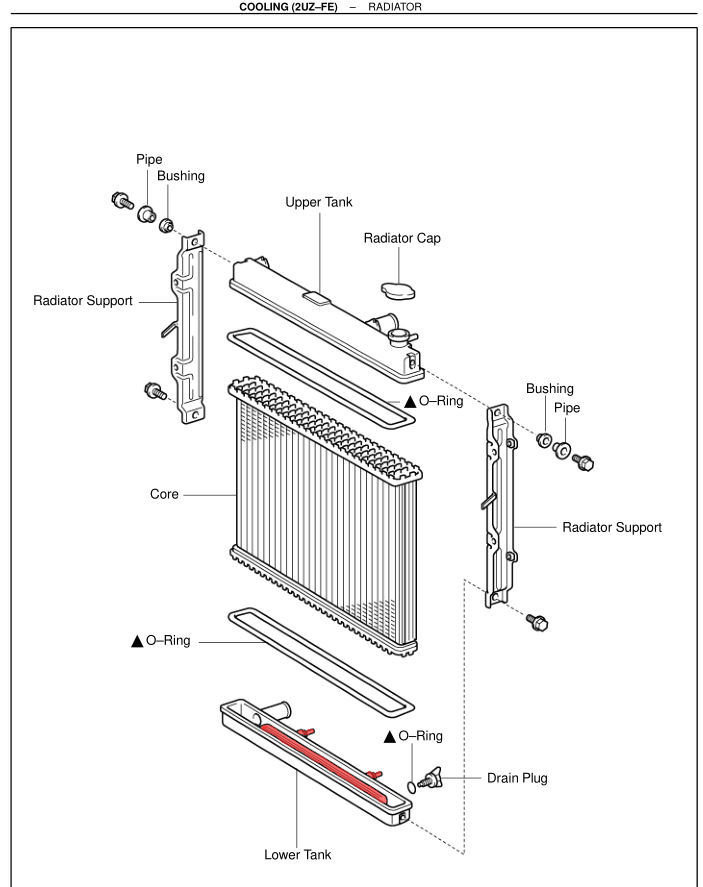

    If you are putting in a new rad I would just hook it back up and not worry. The milkshake comes from that cell (the red highlighted in that pic) breaching into the main rad fluid. I think that's just caused by age of radiator?
