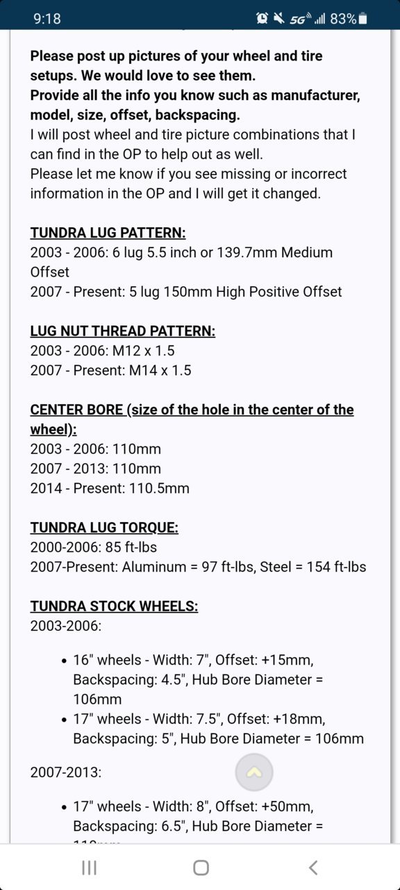

    Hello, as the subject suggests I am looking for opinions on running 3rd gen wheels on my 2011 TRD 4x4. I have read many threads and I know alot of people are running them but I am hung up on the .5mm difference in hub size specifically per the main thread. Are you guys getting any vibrations or have had any issues to share? It seems the best option is a thin layer of aluminum tape to take out the space but if I end up towing or putting alot of weight in the back I don't want to risk issues.

    So everyone can see what I am talking about. Center bore is slightly different by .5mm on the 2nd gen vs 3rd gen. I don't think it's enough to matter but looking to hear if anyone dealt with this or just go for it. The set I am looking at are off a 20 or 21 tundra.

    Good point, I do think I've seen 3rd gens running 2nd gen wheels too which wouldn't work if they were extremely tight tolerances. Still trying to decide if I should pull the trigger or not. I'm just worried if there is space there and I filled the bed full of rocks or dirt or something it could overload the studs. Under $1k for brand new 1794 edition wheels with brand new michelin ltx is such a tempting deal and I could sell my 11' trds to recoup half of that.

    I really wonder if all the hub pilot sizes on “2nd gen” and “3rd gen” are 110.0 mm, and the wheel bore sizes are all 110.5mm.
    Wheel pilots aren’t a press fit, though 0.5mm (0.020”) seems a little bit much for clearance.
    I’ll have to measure the bore of both sets of my wheels when I swap for winter.
