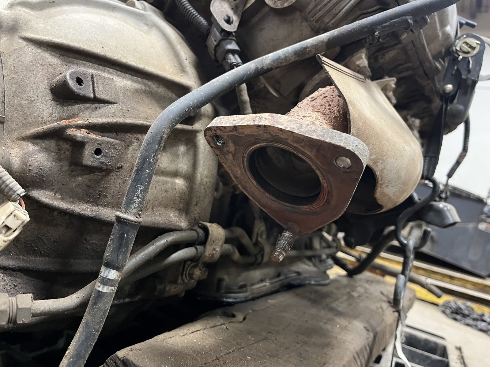

    Looking for all new hardware and a gasket can anyone help?

    Okay, so the new picture you just included seems like you just need a new collector exhaust gasket and both nuts/bolts? Looking for OEM on everything?

    Yes I need the 6 studs and bolts and the gasket

    Yikes! A lot of those parts are discontinued now for the 02 Tundra. I"m not sure about the bolts/gasket. Hopefully still available if you can still purchase the exhaust manifold.

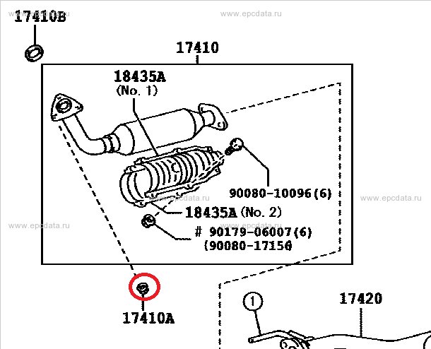

    I see the studs in EPC-DATA's exploded diagrams. for my 2006. You'd need to look on yours. It's under Engine > Manifold. The part number for mine is 90080-12007.
    Go to https://toyota-usa.epc-data.com/tundra/
    Plug your VIN into Search
    Click Engine, fuel system and tools
    Click Manifold
    Enlarge the diagram and click on the 5-6 digit number next to the part you want

    Oh and the nuts are in Engine, fuel system and tools > Exhaust Pipe
    For my truck, it's p/n 90179-10070

    and i just looked close at your pic, and luckily your engine is currently remove from the truck. It will make removing those studs much easier!

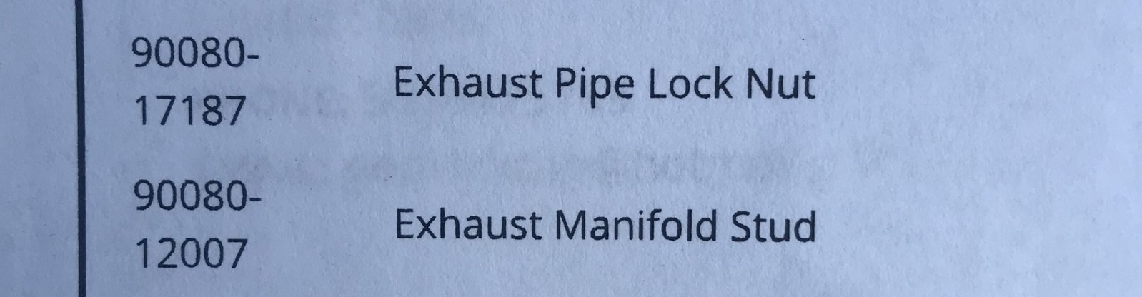

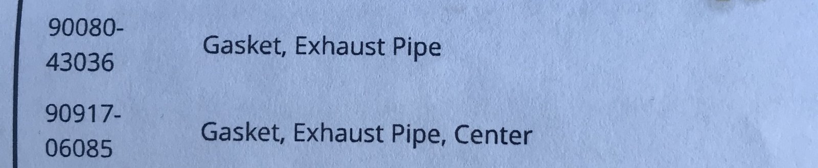

  11. Nov 21, 2023 at 10:25 AM
    whodatschrome
    whodatschrome New Member
    Sep 13, 2023
    #103882
    1,803
    North of North Plains, Oregon
    lots of dents
    here are pics of the part numbers for the studs, locking nuts, and gasket doughnuts that i used on my 2000 4.7 engine and exhaust system. There are two different sized gaskets used in the exhaust, 4 are the same, and the different one (it has a larger i.d. and is referred to as the “center” gasket) is located down near the muffler slip-on coupler that have the V band clamp.
