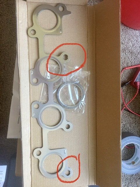

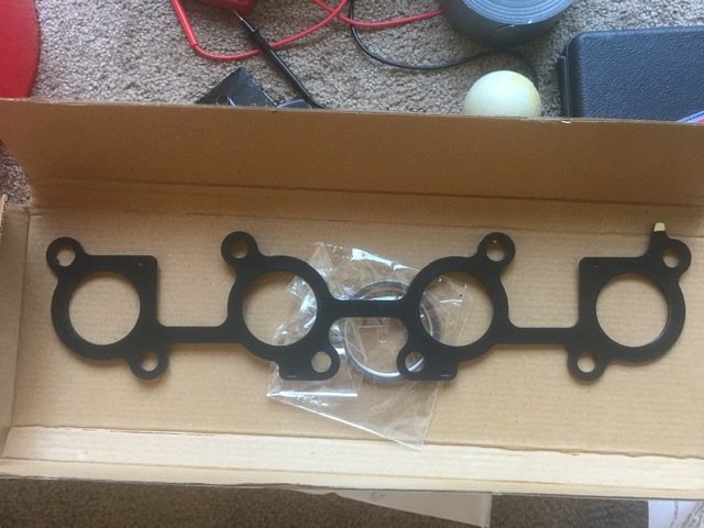

    3B2B0D2E-793D-4033-A9E8-EC86DD9A6C2F.jpg 151107E6-3D4C-4CD2-A3CC-1599EA07BC1F.jpg Just getting ready to change The exhaust manifold. Question on gasket. Silver side faces me or the engine?

    Dark side out, bare metal side towards motor. The protruding tab is white in contrast to the dark finish. Toyota manual says that side goes towards the Manifold/header.

    Oh that’s good to know!! Thanks so much!! Anyone Know why these tabs are like this My guess is to hold the gasket on during install??

    Helps to grab on the stud.
