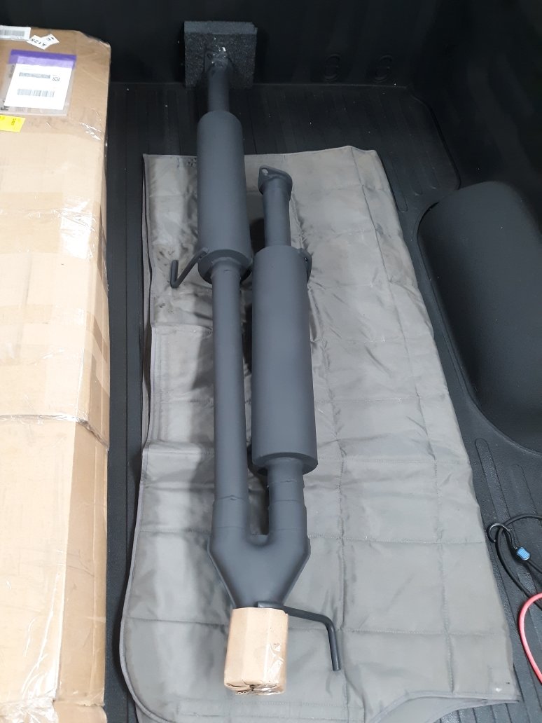

    Helping my Mechanic install this tomorrow, hopefully it'll be the last one!:rolleyes::DResized_20220803_060239.jpg

    What length are those canisters?
    CMikeB[QUOTED] likes this.

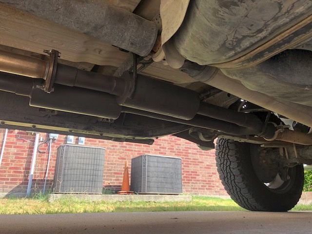

    Dude, you can do that in your driveway in 30 minutes.
    I just did it Monday...
    Although you might want to soak your bolts overnight.
    Mine had only been together 2 weeks.
    https://youtube.com/shorts/zEMoG8Ts1VA?feature=share

    Those are some LOOOOOONG BAMs..:eek2::eek::thumbsup:

  18. Aug 3, 2022 at 8:15 AM

    I was standing behind the truck..:eek:
  20. Aug 3, 2022 at 8:27 AM
    RustyShackle323
    RustyShackle323 New Member
    Jan 31, 2021
    #58409
    556
    Stewart
    NC
    2019 Platinum - Barcelona Red
    Is that the 12”?
  21. Aug 3, 2022 at 8:29 AM
    1lowlife
    May 4, 2016
    #3296
    10,674
    DADA
    THE GREAT STATE OF TEXAS
    2014 MGM DC SR5
    Mine is a 12, that looks like a 20"..:eek2:

  25. Aug 3, 2022 at 11:46 AM

    20"
    dirtydeeds likes this.

    Ha! I went 10, then 14 and now 20.THIS one should do it!:pray:
