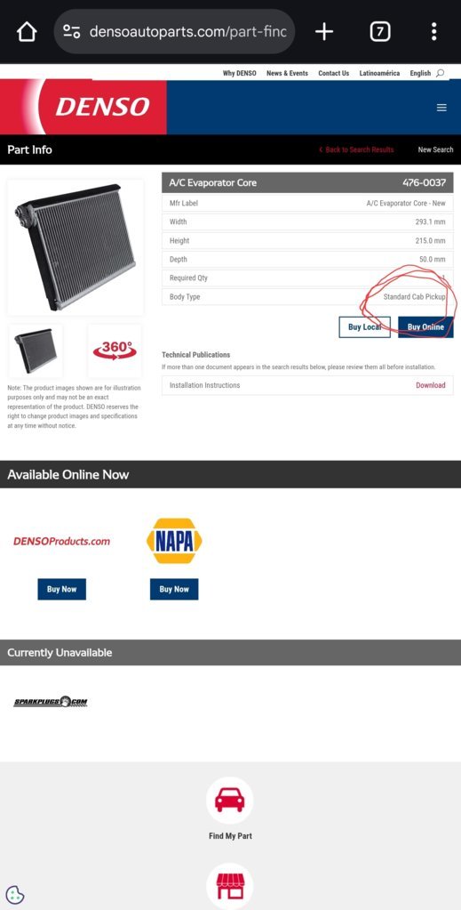

    While looking for parts and prices to renew the A/C system, I noticed the denso evaporator is only for the AC. Screenshot_20250709_124515_Chrome.jpg Screenshot_20250709_124443_Chrome.jpgIs there a evaporator for a DC other than buying the $1,200+ Evap Core and Case Assembly?

    DC has a bigger radiator than AC. I would guess same for Evap Coils. Unless punctured or fins damaged this is not usually a replaced item. Normally hoses, o-rings and compressors are what need replacing.

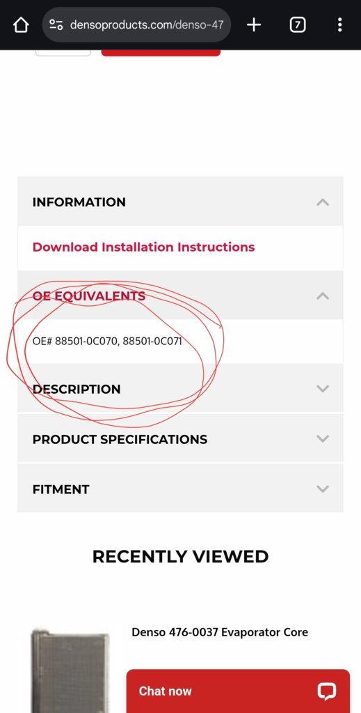

    Using a random 06 DC VIN I found and plugged into the epc, your genuine OEM part number is 88501-0C060. I have found that it is discontinued by Toyota, but can be had in the aftermarket.

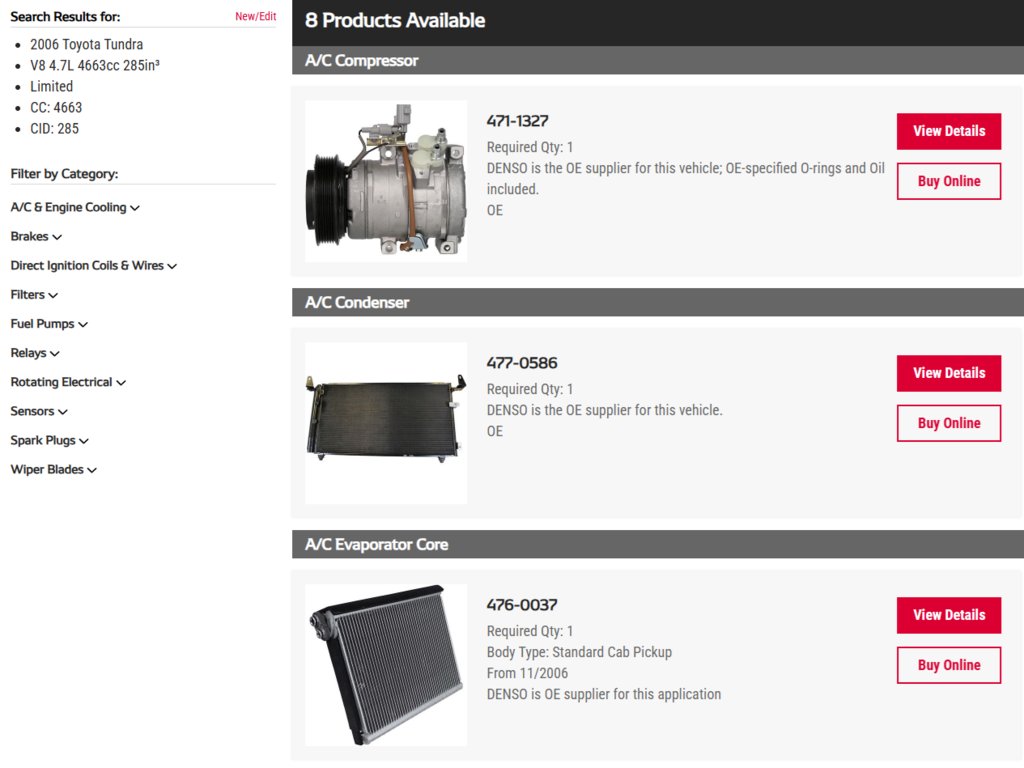

    Condensor or evap core? The one at the radiator support, or the core that's in your dash?
    You and I have the same trucks, different cab. Same year, drivetrain, trim, engine, etc. but different cab. So our parts are essentially the same, minus the radiator.

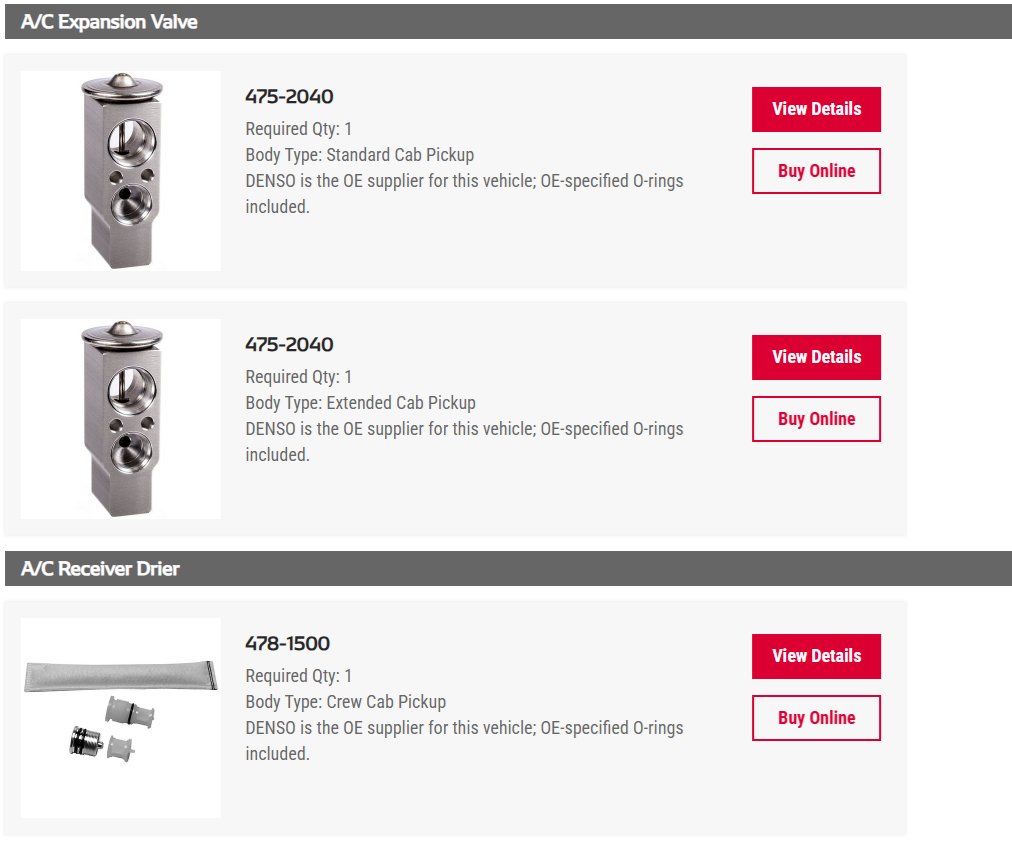

    I always tell everyone to look up your parts using the parts finder at www.densoauroparts.com and when I do, this is what comes up - and when I run the part thru RA's site, the evap core is only $119
    But their parts reference is not perfect, as you'll see with the two different TXV (thermal expansion valve) with same part number and different cab type.

    I plan on changing the condenser as well but I was referring to the evaporator. I wanted to keep everything denso. Looks like the desno evap is only for the AC going off the OEM equivalent P/Ns.

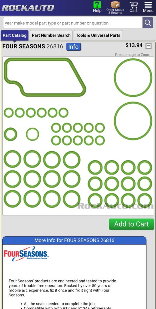

    I am having trouble finding o-rings though. The compressor comes with them and so does the expansion valve. Idk if ill need them for the condenser or evap.
