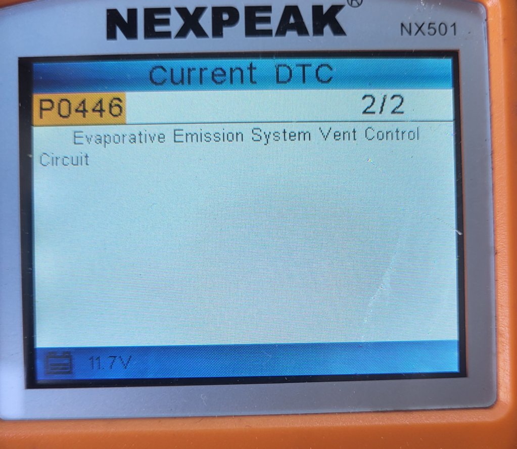

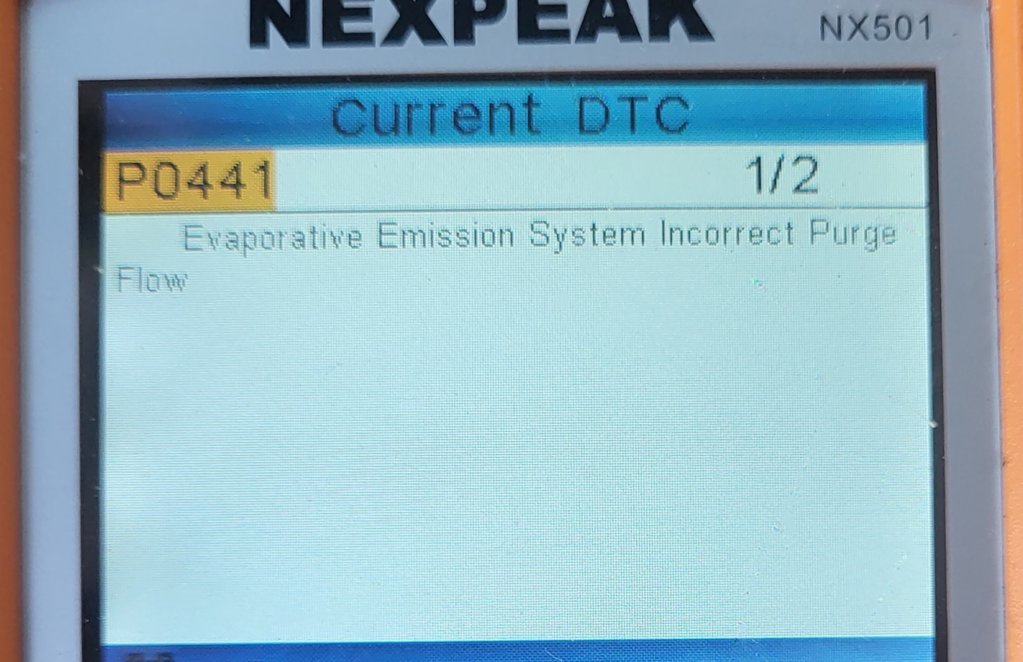

    Okay sorry I didn't think of that. Here is what I see for DTC. There are two.

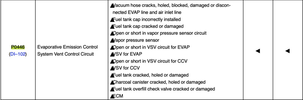

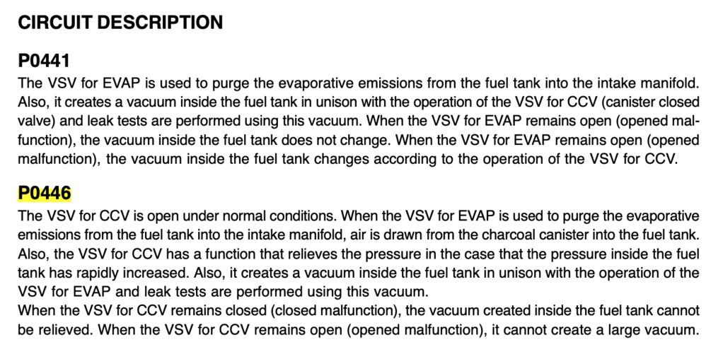

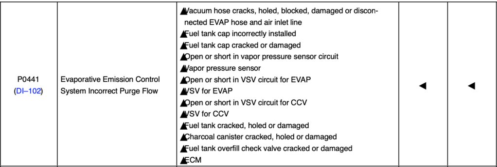

    Here ya go. I'd check those 25 year old dry rotten vacuum hoses first.

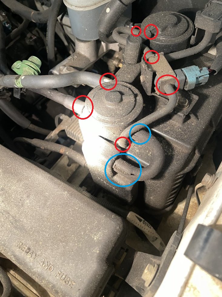

    Post some pics of the vacuum lines and cannister area

    This. @jimer take a pic of the black plastic box with all the vacuum hoses, that lives between the brake master cylinder and the fender (inside the engine bay).
    Sounds like you have some borked up hoses on that thing. There are a bunch of connection points, which I'm circling many (not all) here. Note the two in blue on this guy's are cracked to fuck, and would cause similar codes.
