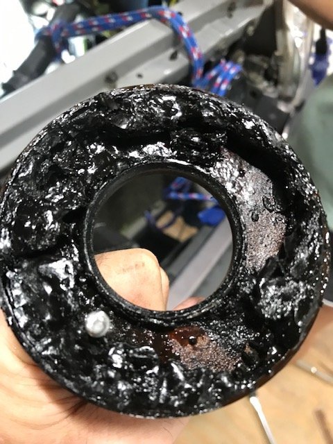

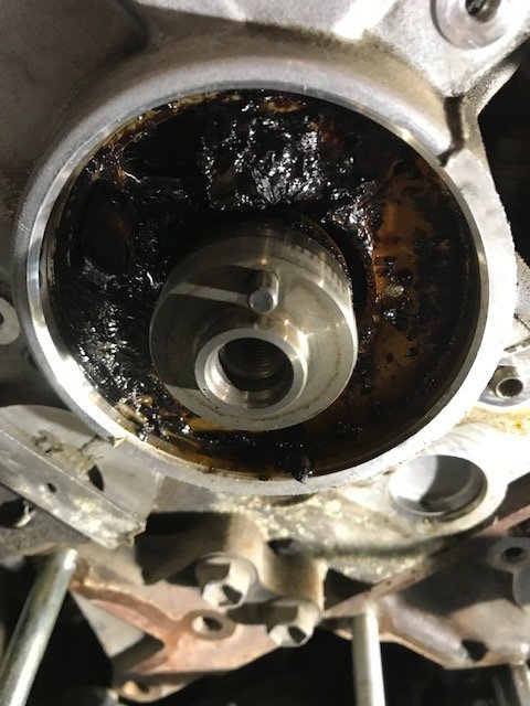

    Middle of Timing Belt - Possibly Cam seals
    Got the cam seals off today and was presented with the seal packed with sludge.
    Anyone have any idea how this happens and what do I need to look at next?
    How serious is it? THANKS

    That don't look good, looks like something I wiped earlier
    Probably a lack of oil changes

    Have you ever checked your PCV valve? Or took a peak under your valve covers?

    not yet, i just bought it last month and this has been the first thing I have done to it. I guess taking the valve cover off is next.
    Is it possible to take it off without doing the gaskets right now? Can I take it off and have a looksee and put it back? I really need to get some of this truck put backtogether before I get too deep into another project. ha
    Assuming there is sludge in the cam case, how/where would it get into this small area behind the seals? Maybe this is old oil that could not get back into the cam case ( i dont know the terms)...like somthing is clogged. The drives side was 1/20 of this and just had a cpl small chunks.

    Hmm, I think you probably could take a peak possibly. I've never done that though. Mine loosen up all the time so I keep a 10mm handy. I need to do gaskets on mine anyways. When I get around to doing my next timing belt/pump change I'm going to overhaul and freshen up several things like that. The truck usually looks immaculate under the hood but oil it's starting to creep out from my covers now that I'm over 400k. As far as the sludge, I don't have and exact answer but if you are just now buying this truck and don't know it's past, I might assume someone ran conventional oil and didn't change it very often and it sludged up but like I said that's a guess. I run Mobil 1 advanced full syn and I reckon that keeps any sludge cleaned out of my engine. I change every 10k but the oil is rated for 20k. If you clean it out and do good oil maintenance with top tier oil then I doubt you'll have that issue.

    I think youre right..nothing to do but crack the covers now. With you having over 400k, I think once I am back up and running Ill adopt your approach of Mobil 1 AFS every 10K.

    Popped the valve cover off and man was I stoked..clean with no sludge. The sludge is only in the small section behind the seal.
    Does anyone know how the oil dispersed from the valve box to the the section behind the seal? If I only have sludge there then maybe its because the oil return path is clogged? I not a mechanic so just trying to figure it out..

    I'd check the pcv and make sure it's not stoped up possibly causing too much crank case pressure and trying to make traces of oil seep into lower pressure places. Just a thought. Make sure that it rattles when you shake it. I just changed mine after 150,000 miles and it was still good but I changed it anyways.

    Thanks..just added it to cart. Anything else I should change out while I'm in there?

    I suspect that level sludge right there is a symptom of short-trip driving and/or infrequent/non-existent oil changes with budget oil. But what you're seeing may by typical for pre-VVTi behind the seals. I think @RUSTYNUTS has changed his, wonder if he found similar.
    Nothing you can do but clean it out, maybe run a treatment or two thru it, and I'm happy to hear you didn't find similar under your valve covers if not already opened up. Some of the rest of us not so lucky, one being my low-mile truck, the other being @AV8R4AA: (example) (example) (example)
    Anyway, clean it up and rest assured it'll flow better after.
