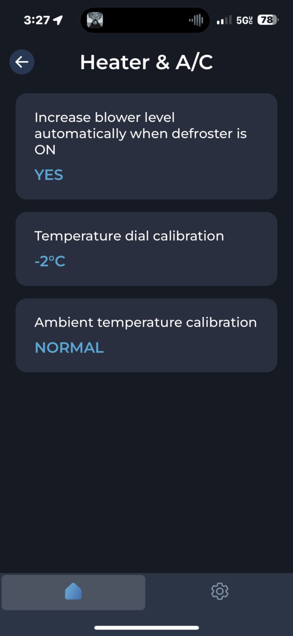

    Just turned it off with Carista wow so much better
    I also did this which helped the ac big time
