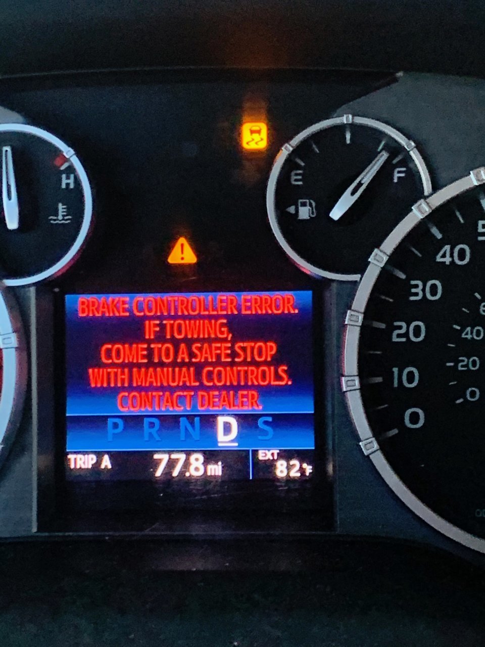

    I was recently driving on the freeway, was NOT towing anything, pretty sure I did not touch any button, and this showed up on my dash screen. Have owned truck since June 2019 (2017 CMOR, 70k miles). Came on for about 20 mins while driving in traffic (30-40 mph). Truck did not make any sounds, didn't drive any differently. Has not come back on and no issues with truck. Anyone else ever seen this, suggestions?? Thx

    There is a software update for the brake control module. Visit your dealer and have it performed. The only way to really properly diag the problem is with techstream to check what trouble codes you may have.

    Thank you. I need to make appt for next weekend.
