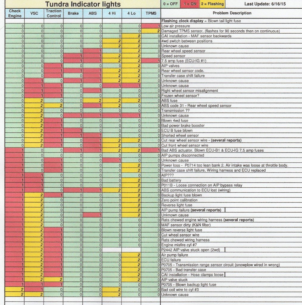

    Well I filled my tank and and 2 wheel drive lights flashing I believe the check edge lights steady and the any skid controls flashing What is up never had codes before

    Clean the throttle body Which I know it was already clean because my local dealership said do it Which I knew it was already clean wiped it out purring like a kitten
