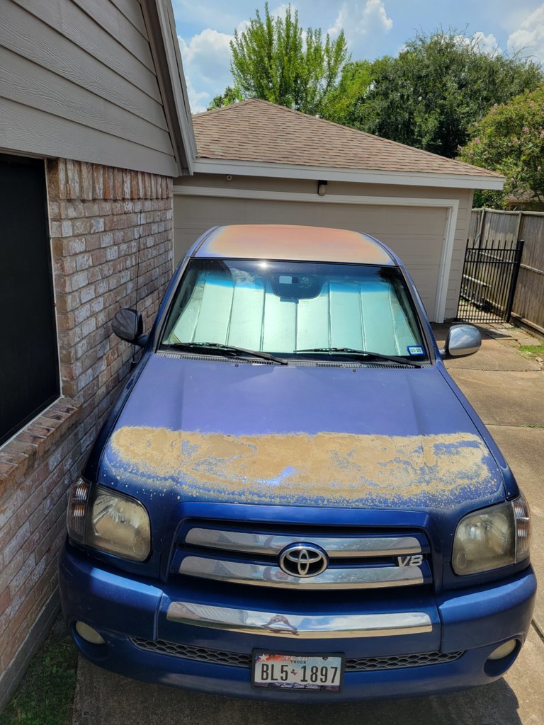

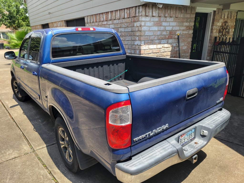

    Before pics - can't help but notice the typical roof and hood rust:

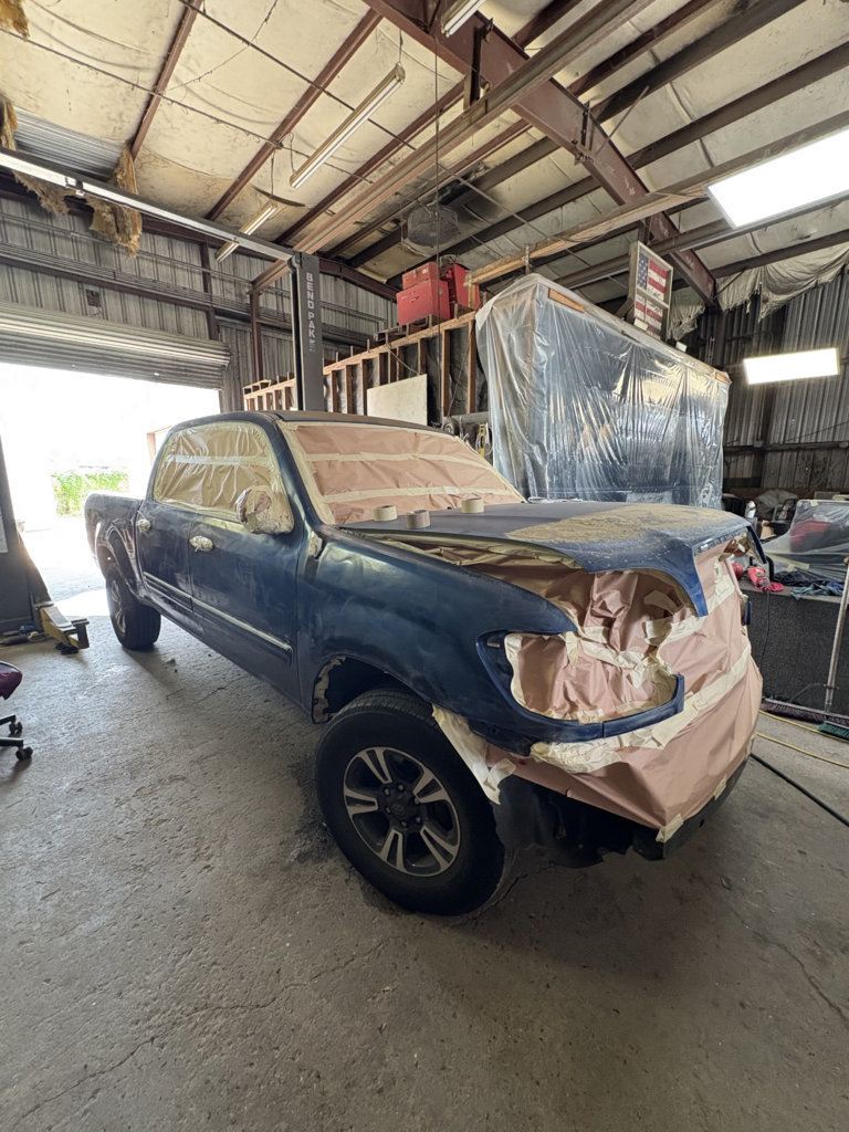

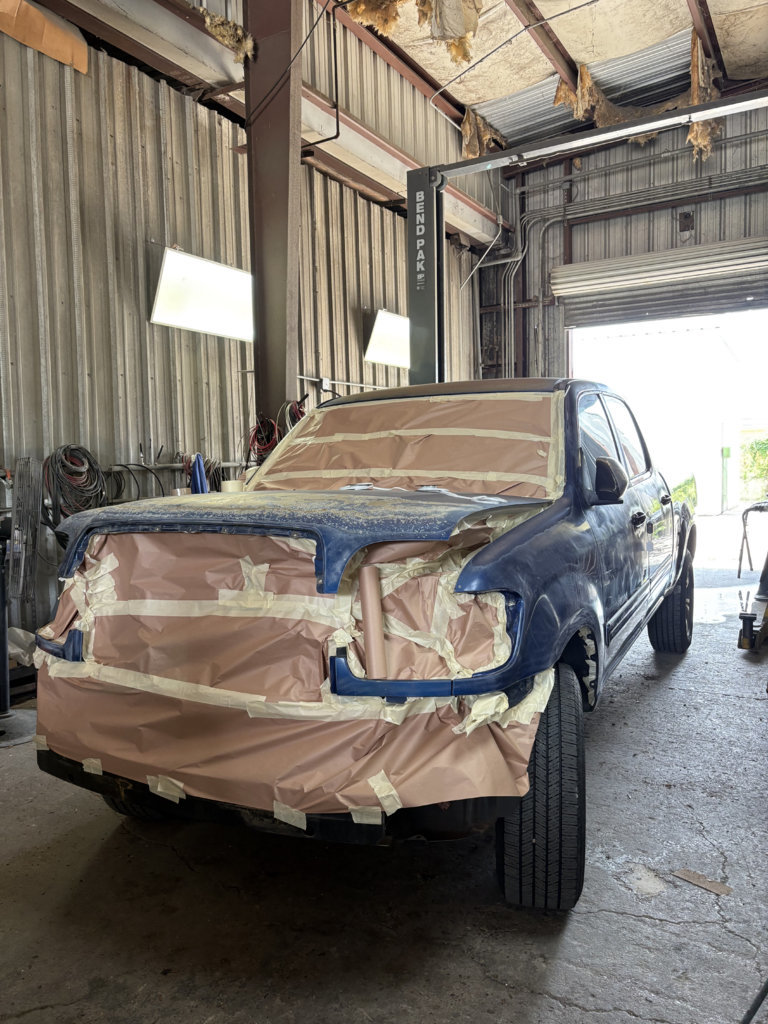

    After pre-paint prep:

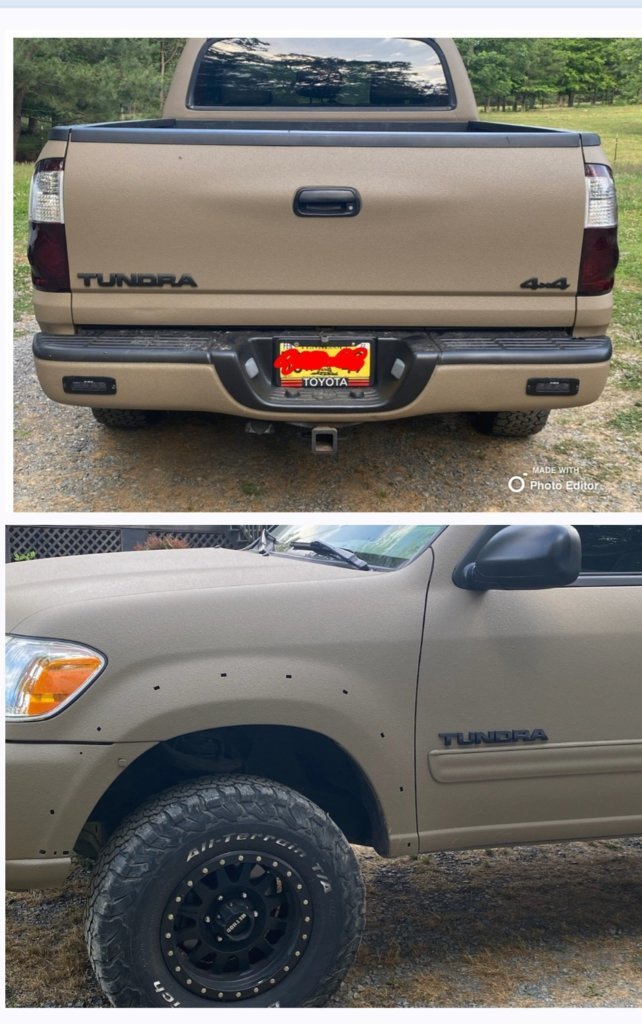

    I saw a guy's third-gen Tundra with a sort of cement color bedliner and I think it's probably the best combo of decent-looking and likely to keep looking decent. Homie went right over the decals and badges and everything--respeck! As to colors, black is right out, any dark color really; they always end up looking chalky and, at best, like a deer lease truck.

    Yep, that’s member @Cummins3500 ’s truck. I haven’t seen him post in awhile but he’s got a few posts on here talking about it.

    I believe @Aerindel 's truck is also as such, but in AC format.

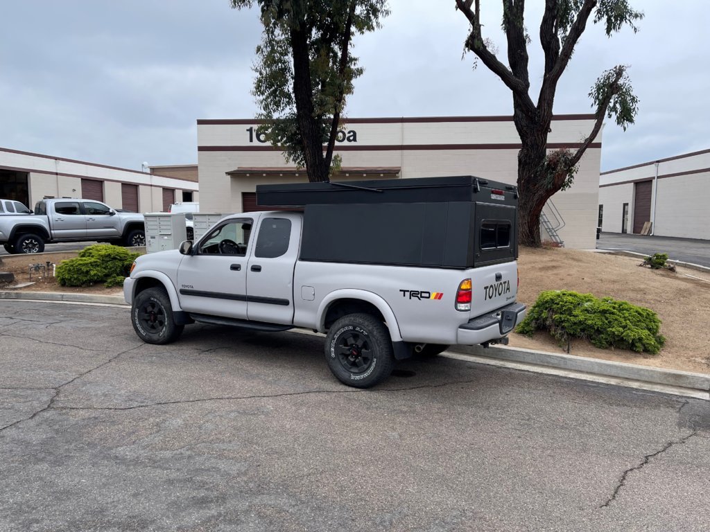

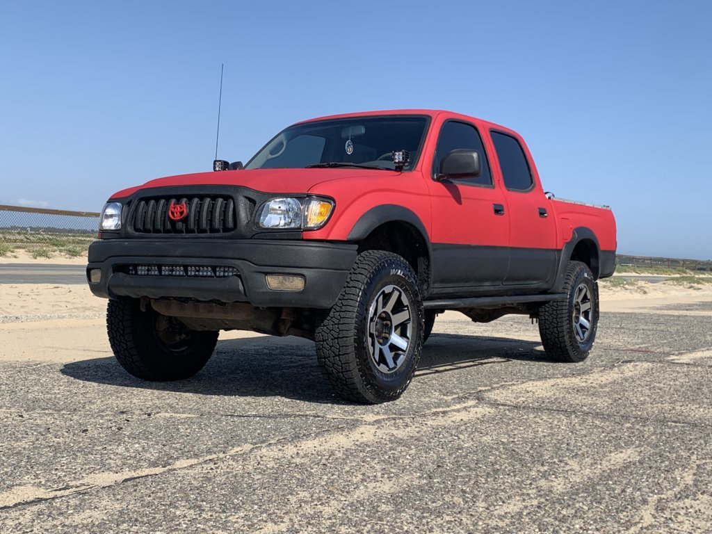

    I bedlined my truck myself back in November 2023. I used Monstaliner and rolled it on over a long weekend. The color is Light Quartz Gray (similar to a cement color, or primer). Overall I'm super happy with how it turned out, a few mistakes here and there but overall looks good for my first time with a project of this scope. Between the cost of the paint and the prep tools/equipment, I spent roughly $800. I put in well over 50 labor hours total but nearly 2 years later, it still looks great and is super easy to clean up and has held up very well.
    Let me know if you have any questions about the process!

    15,099
    Arkansas
    How’d ya do the decals?

    what's with the widdle wadder?

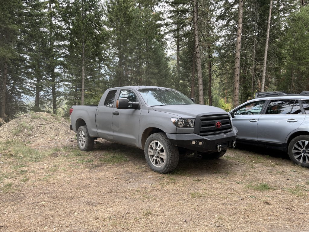

    He had it parked outside today so I snapped some for you. This was a DYI job he did in his driveway, previously it was mismatched red and black, a black truck with a red bed replaced after an accident.

    Probably for being able to climb into the truck bed with the tailgate up. :eek:
    This came out looking pretty good. Especially since it's rolled.

    The decals were put on with a heat gun and sponge to press them into the textured surface. Overall they are holding up but I'm starting to get some peeling on the Toyota tailgate decal. I might have to redo a couple letters in the next year or so.
    widdle wadder for a big twuck
    Thank you! There's a few spots where the roller lines are visible, and if I could do it over again I'd be more meticulous about my final coat to eliminate the lines. But unless you're looking for them, it's hard to tell.

    Well from the pics you posted we can't see any. I rolled a textured durabek liner on my truck bed and I know what you're talking about with the final coat. How many coats did you roll? This isn't my best pic but one I took right after it was done. The bed liner took a full day. IMG_8602.jpg

    I rolled 2 coats! Yours looks good too
