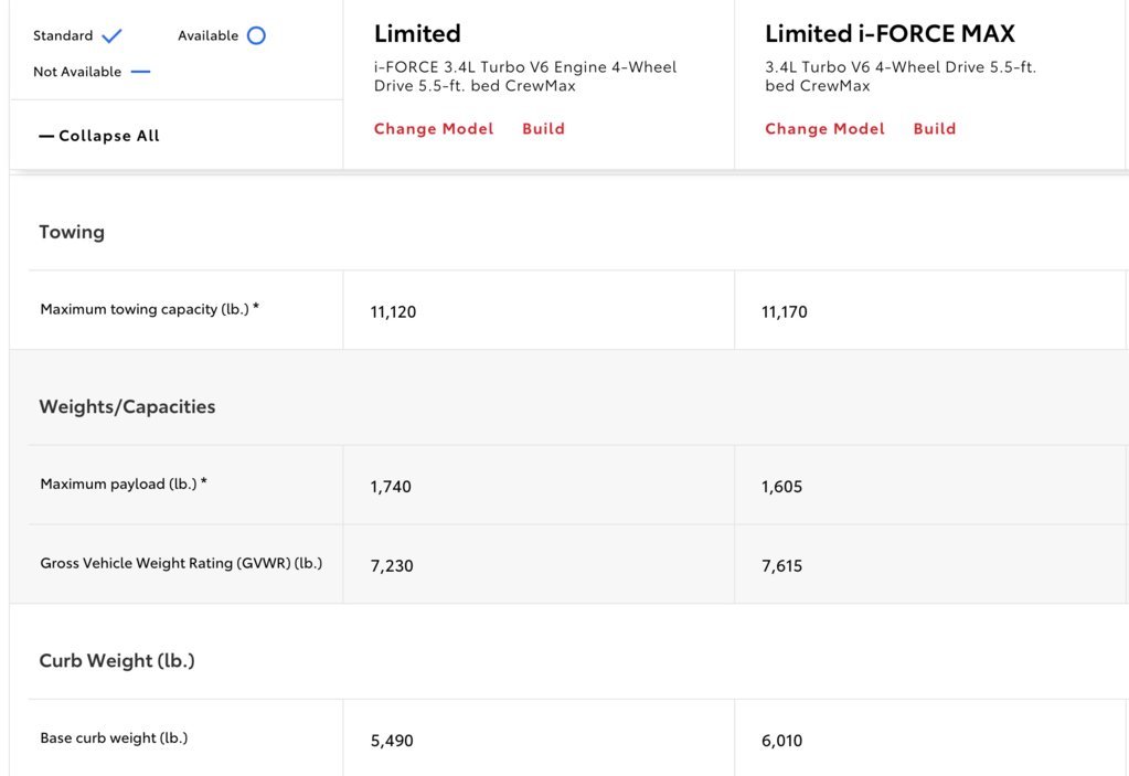

    I'm planning on getting a travel trailer in the near future and have been educating myself on all that goes along with this. Currently I’m reading about weight distribution hitch’s and how its recommended (rule of thumb) if your towing something greater than 50% of your curb weight.
    I have Limited non-hybrid 4x4 Crew cab listed at 5490lbs curb weight on Toyotas website. I used to simple math with the listed GVWR to work back to the listed payload rating and everything fit so it made sense. On the comparison column next to my truck was a Limited with the same configuration but with the hybrid drive train. The curb wight is 520lbs more which also makes sense due to the battery and extra hybrid equipment.
    That being said the math didn’t work out the same for the Hybrid when I worked it back to the payload. The payload rating is very close to the non-hybrid with a 520lbs weight difference. How did they do this? Do the hybrids have different axils or something like that to change the numbers?

    Being a cynic you could think that it's an artificial limit on the non hybrid to prevent the loss of sales on the more expensive platform due to it being drastically worse on paper. That is just speculation. To get the truth you'd have to ask the engineers why they rated it the way they did. You won't find that info on an enthusiast forum, and I doubt the engineers can talk about it.
    You also need to stop looking at online charts and marketing pamphlets for the ratings. Look at the sticker on the actual truck. Few ever hit the numbers advertised because the magical configuration to hit those numbers is seldom if ever built. Don't look at generic charts, look at what is on your actual truck. Those are the only numbers that matter.
    In any case the how doesn't really matter "how" they did it. The payload rating is what the truck is legally rated for and you can't change it. Work within the limits and don't sweat it, or blow by them and accept that the liability is completely on you at that point.

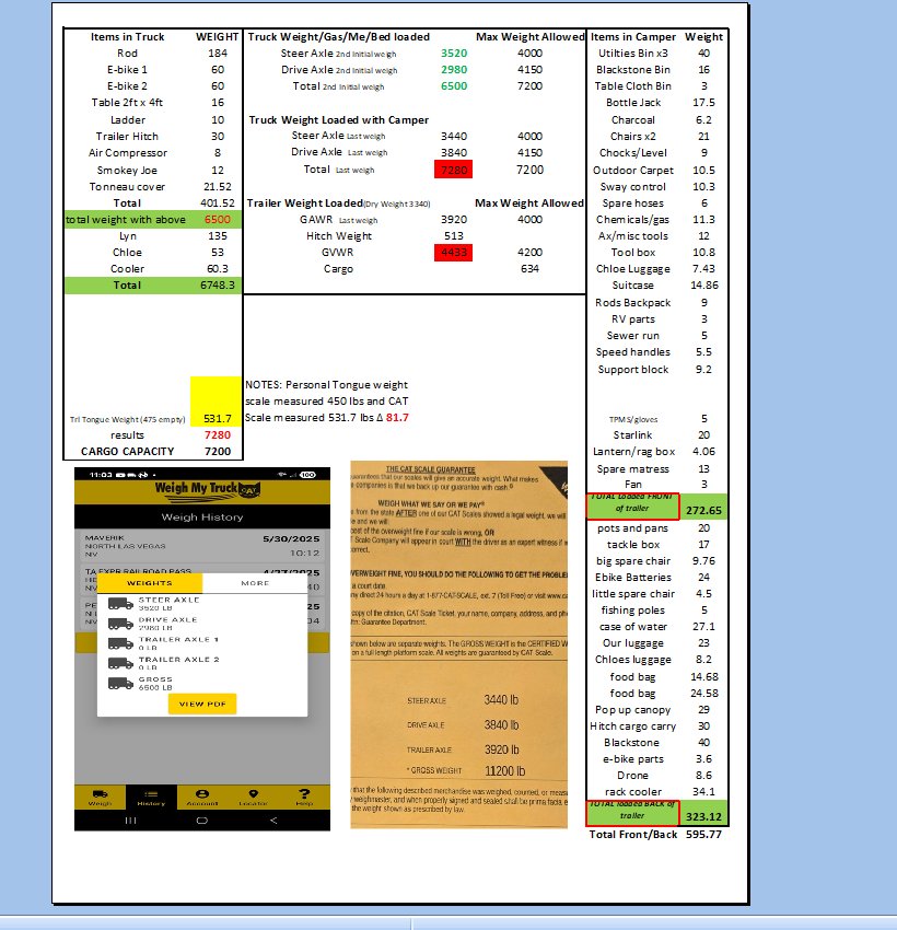

    Ya your first step should be weighing the truck with a full tank of gas and you in it.
    Weight adds up quickly

    I live in Las Vegas and hit the Cat scales at truck stops at least 4 times and drove straight up. The truck stops always have numerous trucks either refueling or parked, but haven't seen one on the scales yet.
