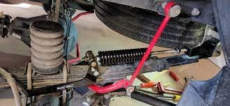

    PS>>> Regarding the suspension side of your question; a lot of folks here have talked about and gone with the Roadmaster Active Suspension setup and seem to really like it. It may be worth looking at....

    I have had two tundras and put RAS on both. Absolutely awesome for a half ton truck.
    I don't think it is necessary. I added one to my 2020 but that was because I had to max tow several times a month. I think with install I was $1K out the door.
    For suspension, I would add a rear sway bar and roadmaster active suspension. That will tighten up the rear end and make things feel very stable. It's not needed with the bass boat but if you get up into the 8k-10k you will want this stability.
