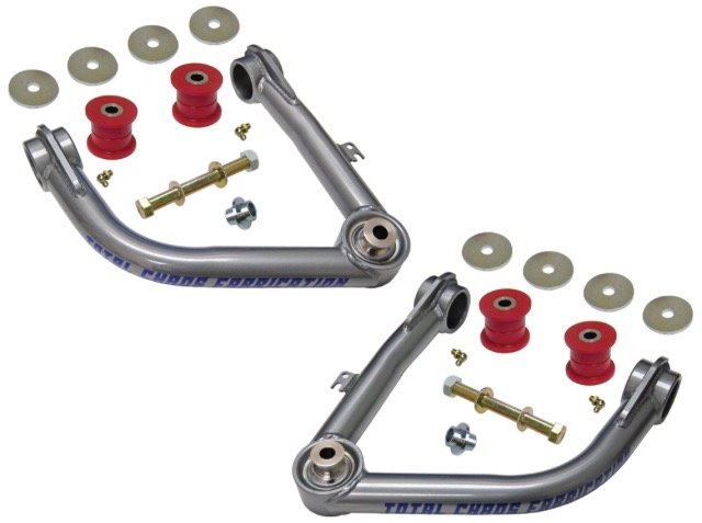

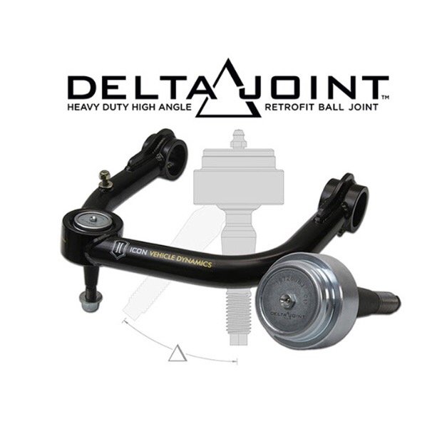

    Did the delta joint de-throne total chaos as the best UCA? Give your thoughts and reviews, thanks

    All you did was post pictures. Care to explain how the "delta joint" is better than a fk uniball?
    If you are just looking for opinions, then get total chaos.

    Depending on the materials used. TC from what i remember uses chromoly tubing and is stronger than the other contenders for UCA's. The uniballs all use the same diameter shaft which would most likely be the first part to break, not the uniball. I'm happy with my TC UCA's; no grease, just spray! I also ditched the poly bushings and replaced with uniball pivots.

    I just installed the Icon Delta joint. I like the idea of articulation without frequent maintenance. Also, sand from Pismo won't be an issue. TC, and Camburg make great stuff too. I think TC uses a 1" uniball and Camburg uses 1.5".

    The Delta Joint was designed for the climates that the uniballs have not been able to stand up in. I.E snow, road salts, high moisture, etc. The Delta Joint in simple terms is a "sealed uniball" that is greased instead of using a teflon liner. ICON is estimating these to have life spans of at least 100K. The benefit of the Delta Joint is that you don't get the noises that are accompanied with a dried out or worn out uniball.
    When comparing the uniball straight across to a Delta Joint, the Delta joint does have quite a few advantages.
    1. No noise with the Delta Joints
    2. The Delta Joint has a stronger pull out strength compared to the uniball.
    3. The Delta Joint is a one piece design, so no more misalignment spacers or broken spindle adapter spacers.
    4. Comes with a 5 year/100k warranty when used with Icon suspension kits
    5. Delta Joint gives you the same high misalignment angles of a uniball.
    Only con would be cost of the delta joint vs a replacement uniball. But how many sets of uniballs will you go through in 100K miles? I would say ICON has the upper hand in this battle. They are in testing phase with the WSSX16T delta joint size which would be for the Total Chaos products and some Camburg. Mid to late next year they will have the larger Delta joints that replace the 1.5" uniballs. I like to think of myself as the Icon insider. :p

    Both Camburg and TC use 4130. Icon uses DOM. But with that being said, I've never seen either bend or break under non-race circumstances that wasn't in a wreck, etc.
