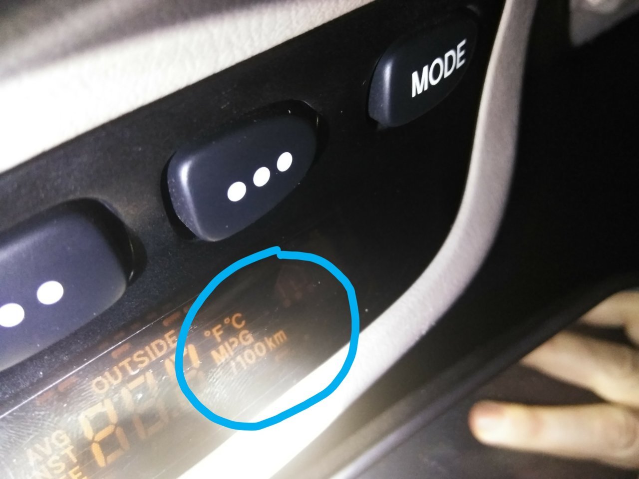

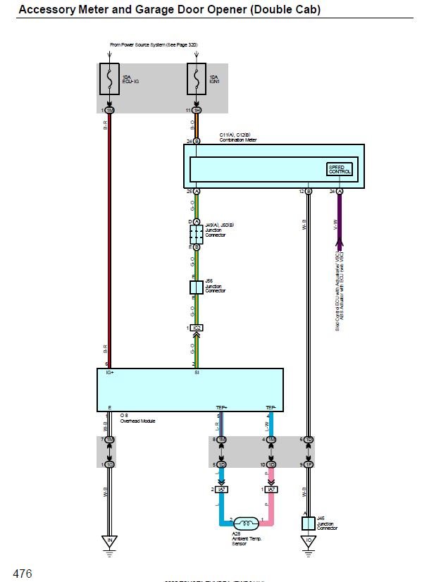

    I took the overhead display off last night to wire both of the map lights together.
    I noticed the LCD display where the Outside temp is displayed, I could see a MPG section on the right hand side of the display. Is there a way to use it? or Add the funtion.

    From what I can find the sequoia and sienna's show temp, compass, DTE, MPG but not in the Tundra. Trying to figure out if I can make it work on my truck

    It may be in the OHC itself if the wiring is already there.

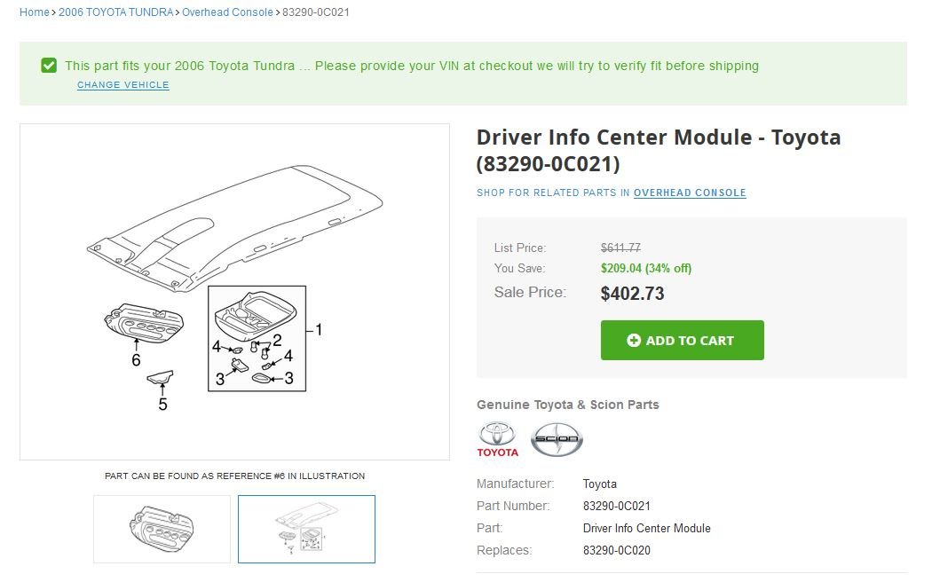

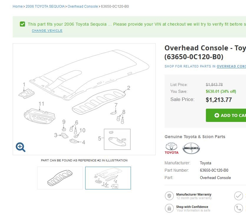

    I think you're right. Searching parts for cross reference it appears the Sequoia and Tundra spec different readout modules.
    Sequoia part
    Sequoia module parts. Interesting that neither 8 nor 11 show a Toyota part#
    Tundra module
    Tundra module #

    Yep,
    I I need to hit a junk yard and find this part and look at the wire harness and see if it looks like mine.
    Maybe all I need is a different overhead module? And it's plug and play?
    Some how I think there will be more then just plugging in a new Module.
    There is a guy here at work with a Sequoia close to the same year as my truck. I'm going to ask him if it has this MPG display.

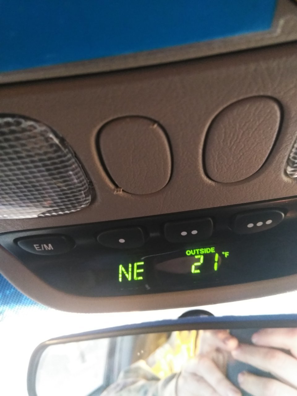

    Yeah I already have the temp and compass this pic is from my truck.

    Darkness, are you saying you can see a mpg and miles to empty readout from a scangauge in your Tundra? If so, I think that another question is answered as there was concern the Sequoia module was perhaps receiving information from the ECM that was not being sent by the Tundra ECM, thus necessitating two unique module designs. If that data is being sent by the Tundra ECM, then the lack of module interchangeability may just be due to shape or size. We really need to see the module plug and socket from a Tundra vs Sequoia to gain a better understanding.
