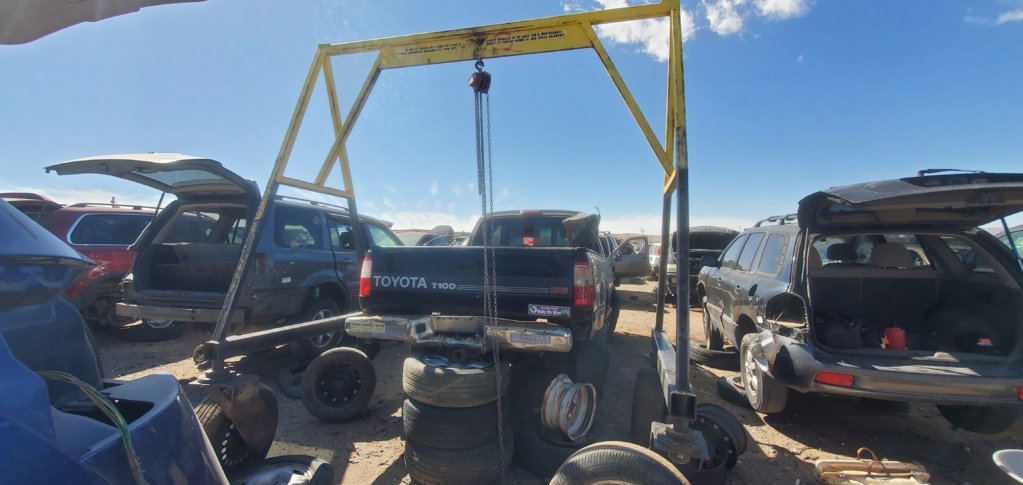

    Heres a pic from my last junkyard trip because I dont have any of the tundra on my phone.
