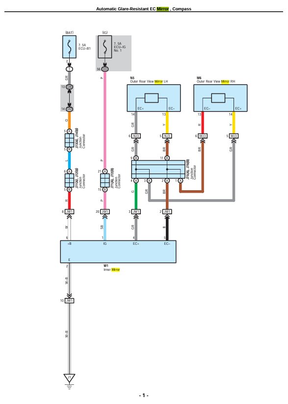

    Hi All, First post here. I have a 2007 Tundra SR5 double cab and I would like to install a dash cam. I would like to use one of the power splitters that gets power for the camera from the mirror connector (linked below). I have the basic mirror with no electronic features, If I buy a mirror with the compass and garage door features is there a connector in the headliner that I can connect it to? or are the cables not there for the mirror if it is not installed from the factory?

    Maybe peel gently the headliner back and see if there is a connector.
    Should look something like this..
    Here is a wiring diagram for that connector.
    You can find wiring diagrams here..
    Ultimate TUNDRA Wiring Diagrams Collection | Toyota Tundra Forum (tundras.com)
