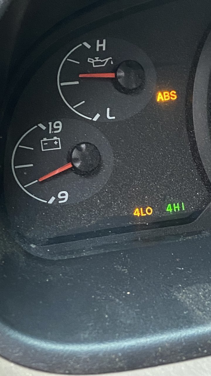

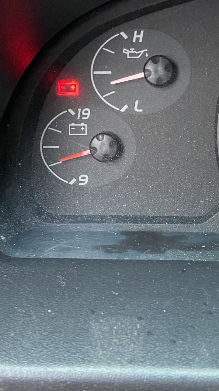

    Having some weird electronic issues.
    • Wipers started running nuclear fast when on
    • Battery light on, along with lower charging, and then seems to go away and comes back
    • Battery light is NOT on but showing lower charging
    • Intermixed is lingering code P0500 (speed senor) that comes and goes, but not sure if related
    • When I run a code checker, it is pulling zero codes
    • Some dash shots shared at various stages
    • My battery is new (last 6 months) and is an AGM
    Any thoughts? General thought would be (1) Serpentine belt is ready to be changed ( but not hearing slipping noise) or (2) alternator is going in and out.
    Any help / thoughts?

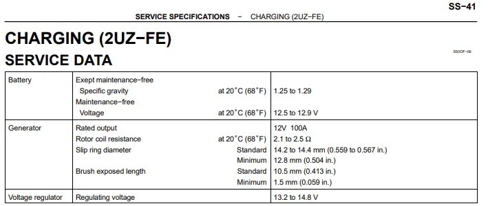

    While that voltage falls on low side of what most alternator voltage regulators put out, I personally like to see something above 14.
    from 2005 Tundra FSM....
