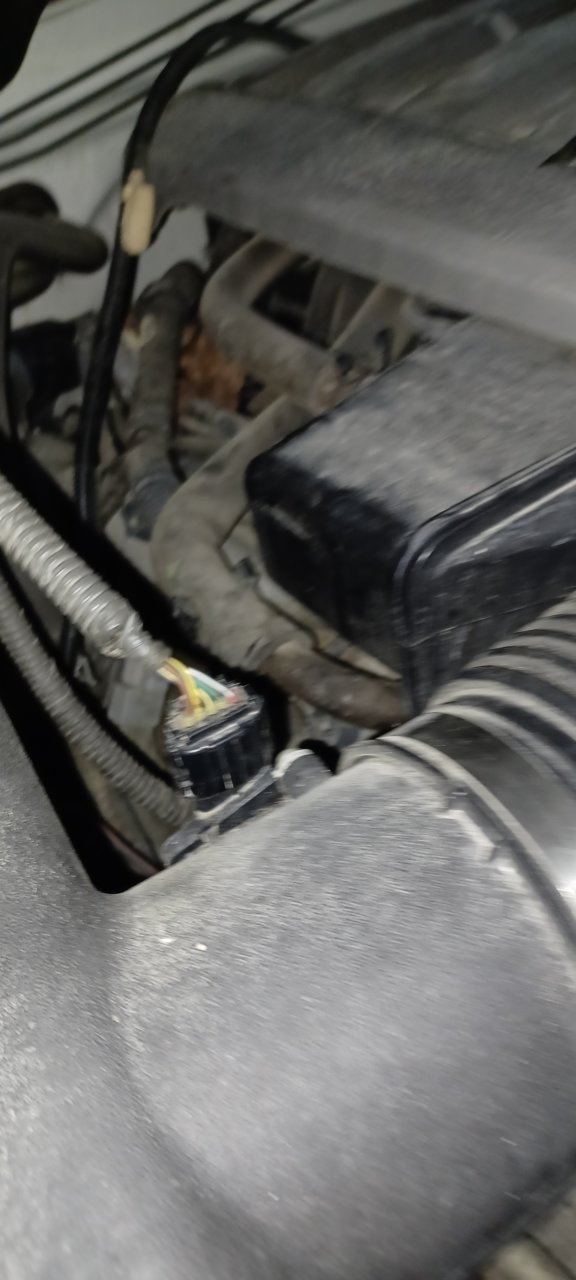

    can someone identify this for me?

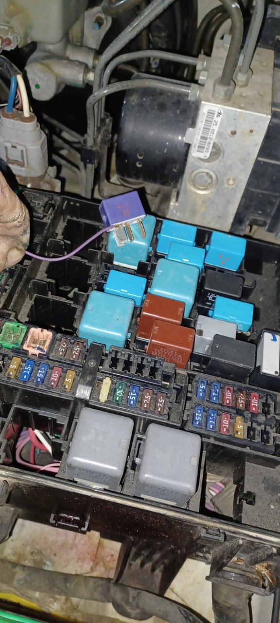

    upload_2023-2-27_9-51-40.jpghere are a few more pics, to show how it is wired.
    ....i feel like I would have noticed this before now, seeing hoe I've owned this truck for over 4 years.
    ...what Is this?

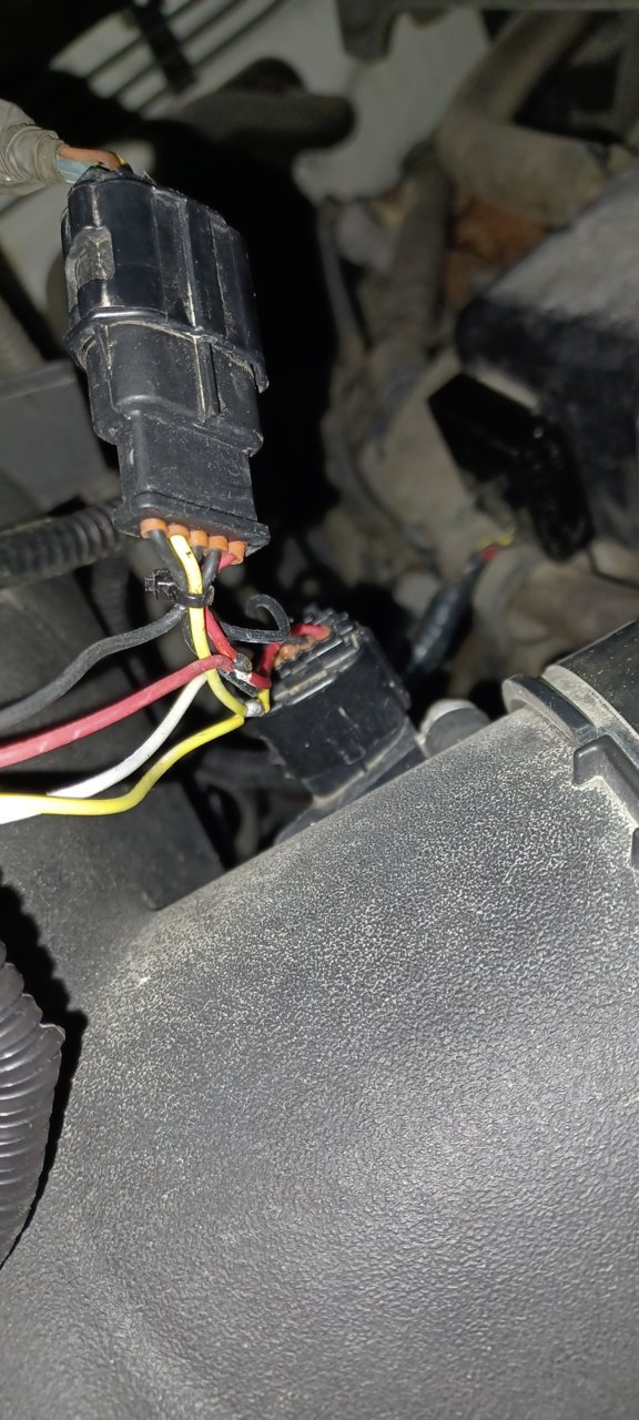

    this is the harness " they," used to jump off the mass air flow sensor,
    ( this pic is how it looked hooked up, with me trying to get a good angle for the pic)
    ...ill post another pic

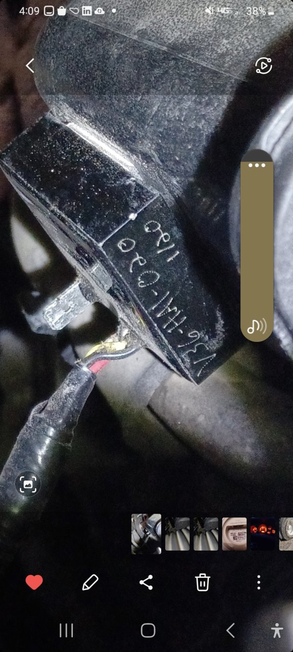

    H]

    That's a Hewitt Technologies Secondary Air Injection System (SAIS) bypass module and associated wiring. It's intended to prevent the SAIS system from running on startup for certain conditions either because the system is malfunctioning or as a preventative, before they fail.

    .....I did unplug it, and I'm glad I reconnected it. I hope i didn't mess it up. I tried to start the truck without this, and it would die after a short time idling... after 3 attempts, I plugged it back in, just as it was. The 2nd gen crewmax with 236k has only been in my posession for just a few short years, and it's been a great truck but full of surprises.

    No, you didn't mess it up. Sounds like there may be something that may not be working correctly with the SAIS system and that's why the bypass is there. :thumbsup:
