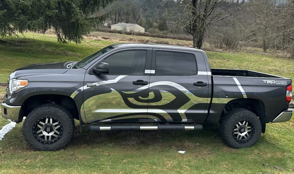

    Well there’s your problem right there! It’s all over the side of your truck! I’m pretty it’s protesting the Seahawks.
