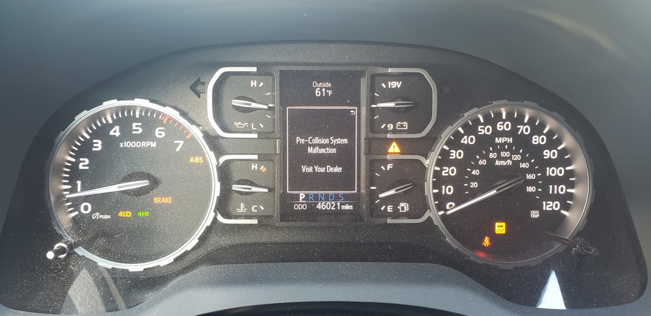

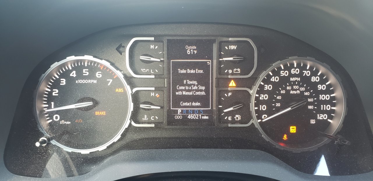

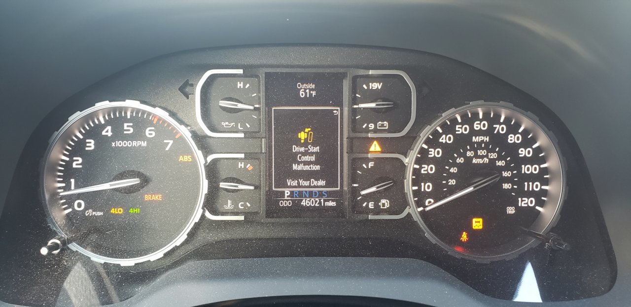

    I'm hoping someone on here experienced the same problem I'm having and found a solution. 9 out of 10 times when I start my truck every light on the dash lights up or flashes. At the same time three different messages cycle through on the dash ( see pictures). I brought it to the dealership and they blame it in the fuse taps for both the dash cam and radar detector. They disconnected them and started the truck several times, and of course the problem seemed to disappear. I left everything unplugged and the very next day the problem returned and hasn't gone away. If someone has experienced this problem and found a solution I would be more then grateful for the solution.

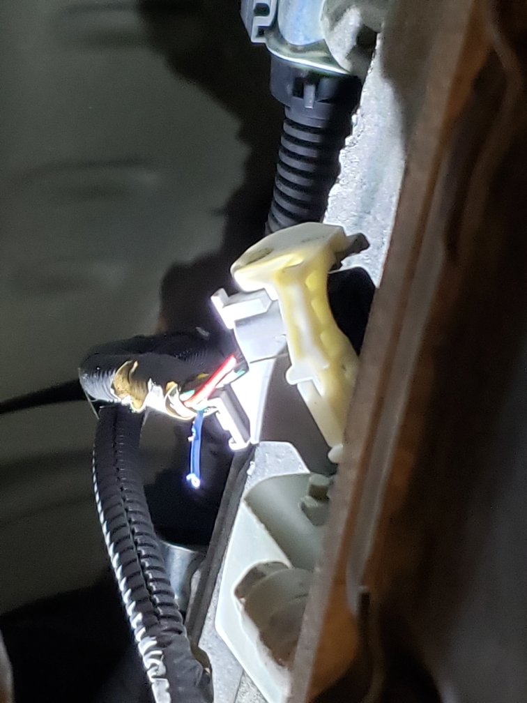

    Just ran into the same problem on my 2019, 24k miles. Ran fine last night, this morning went to start it and all the lights lit up and it is cycling through the messages. Dealer said to check under the engine cover and fuse cover to see if there was any evidence of rodents. Both were clear. Dropped it off this morning for them to look at. It was just in for an oil change and to rotate the tires this past Friday. I see one of the issues above was a bad wheel sensor. Possibly they damaged it when rotating ? Probably won't hear back until sometime tomorrow and will update once I do hear back.
    Edit to update and add picture. They said this wire was located on the driver side, near the transmission. Can't say for sure it was rodent damage but that is most likely the cause They said possibly something was hit on the road that might have bounced up but I am thinking more likely an animal.
