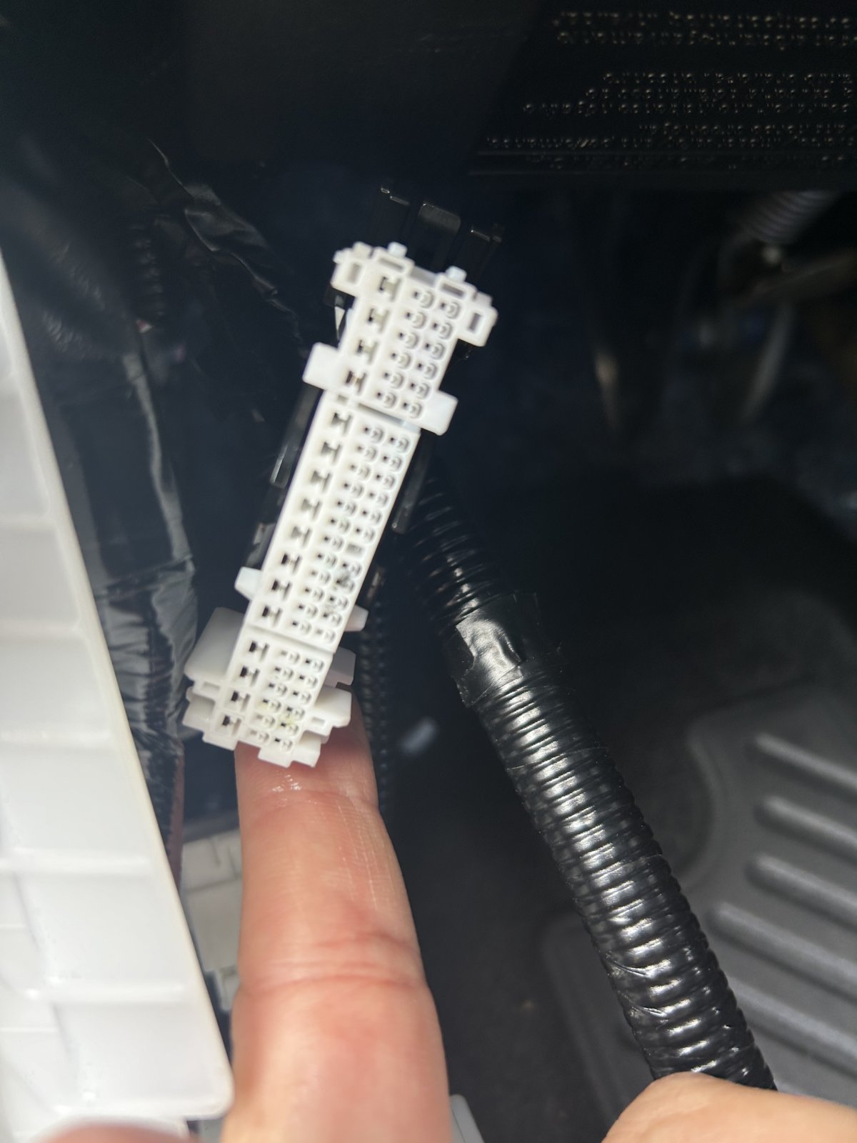

    Spent most of my day at the dealership. Got the techs to clean and add dielectric grease. Something they should have done on day 1. Truck is running like it should and I got it home. Going to inspect the wiring when I get a chance. I’ll post some pictures when I open it up. They did show me some pictures but they were hard to see details. I could see a little discoloration. Highly doubt there’s much damage from corrosion at all. Thanks everyone!

    Pulled the kick plate off today and disconnected the Al1 connector. No sign of any dielectric grease or anything. I ended up using a small paint brush and dipped it in Corrosion-X and carefully added a little to both sides of the connector. It looks fine and should be good to go. Did the same to several other connectors in the vicinity. Sorry for the bad pic. Between sweat in my eyes and no-seem’s I couldn’t get a clear pic. I read another post on how to simply reinstall the kick plate. Very helpful!
