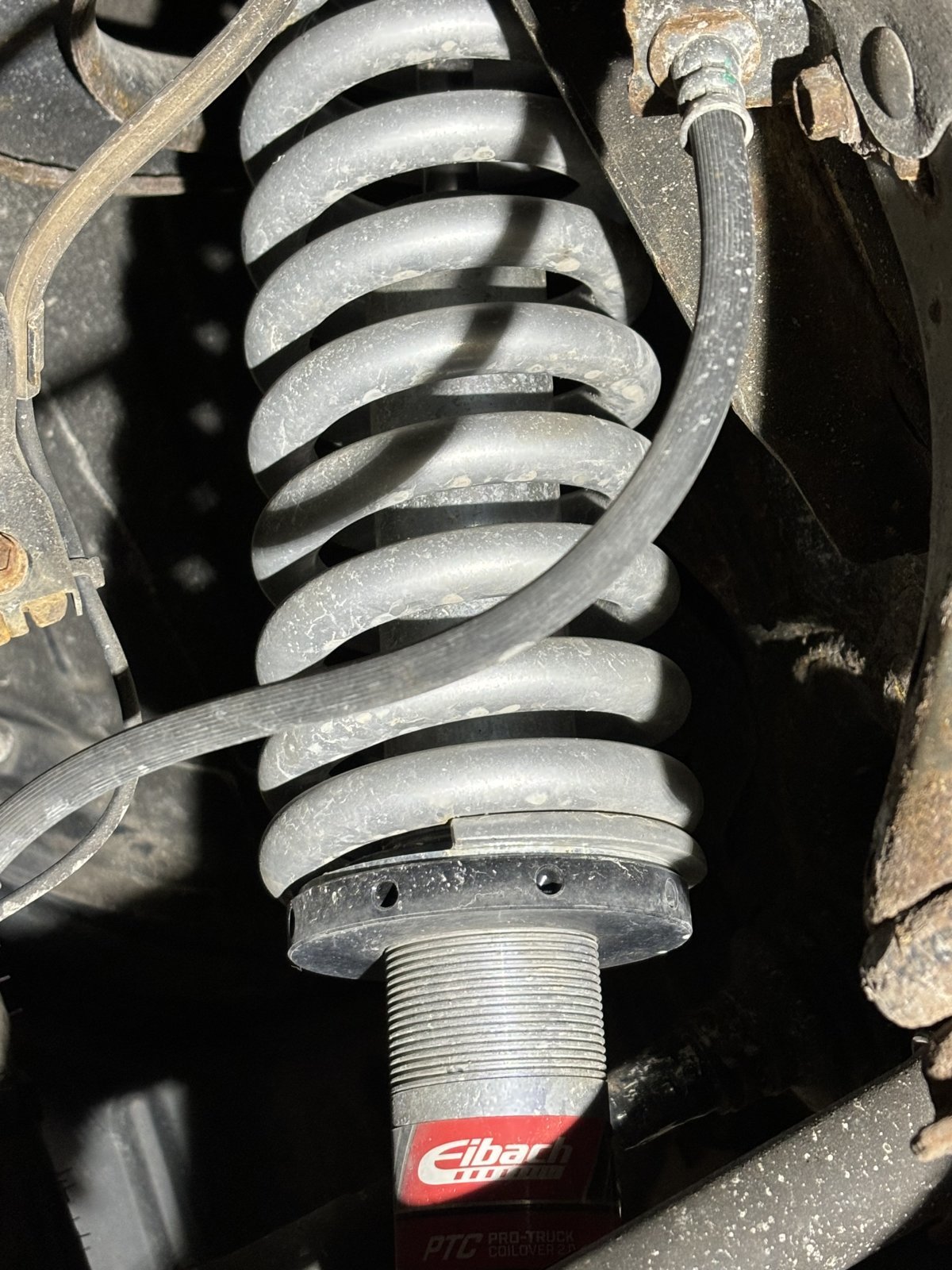

    2.5” of lift on stock UCA’s could cause some issues. Also, what is your tire pressure?
    Two nice things about the Eibach coilovers: you can turn the height down easily without disassembling the coilover, and you can swap springs easily for a different rate 16x3 coil. The kit should come with 650lb/in but you could conceivably go down to 600 lb/in. But if you want max height, you may be loading the existing 650 lb/in coil too much causing a harsh ride. I believe Eibach cautions 95mm of maximum thread exposed when raising the front end.
    Posy some pics of the spring pack and the CO setup.

    I had a similar situation when I put eibach 2.0 on my tacoma. It was crazy harsh. I had to crank it almost all the way down to get it to feel somewhat better. Still stiff, but not as jarring. I was almost all the way down on them, but still got over 3" of lift out of it. Try that. It's easy enough to adjust them.

    So rough measurement this morning of hub to fender - driver side was 23” and passenger 23-1/4”. Snapped a quick pic of the coilover threads too.
