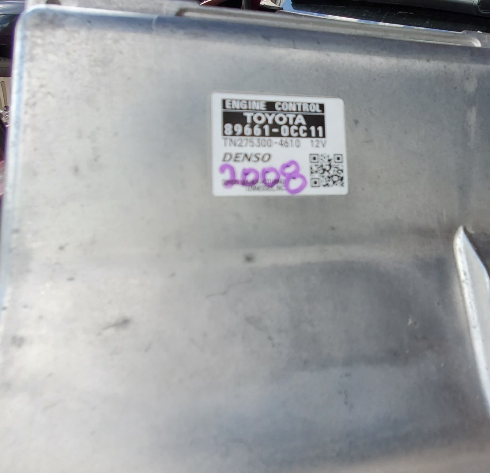

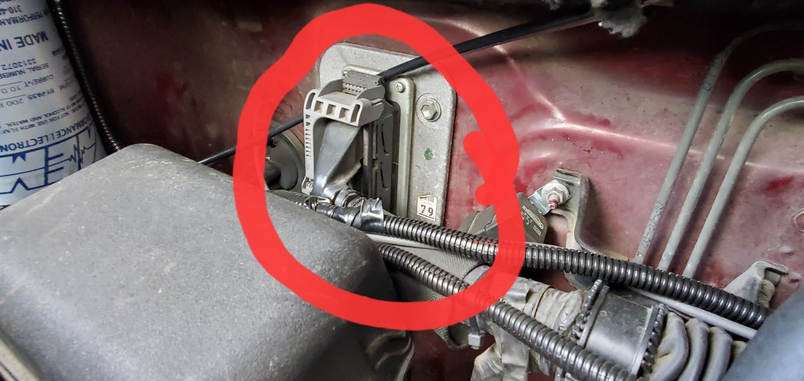

    Look at the ecu part number from your truck. Buy one on ebay or dealer that has the same exact part number. That way it is plug and play and you don't have to do any reprogramming. I got one one ebay for$125. Works just fine!
    **It's on the passenger side firewall. Disconnect battery and remove two connectors and mounting screws. Part number is on the side of ecu.
