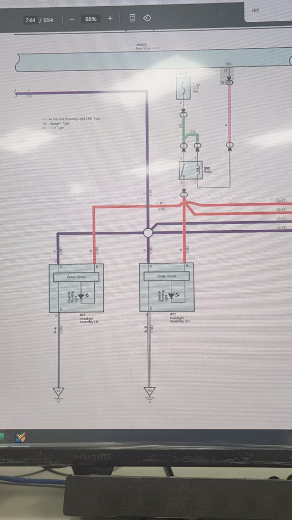

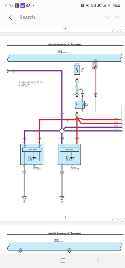

    Hi, new Toyota owner since last month of a 2021 Tundra SR5. Ever since I got the truck, the DRLs have never turned on while driving. They only work with the manual selector but never work in AUTO. My truck is equipped with DRLs on headlight , there's a Drl relay, LED Drl fuse and even an option on the headlight selector to set DRLS TO OFF.... I've verified fuse is good (OHMed out), swapped the relay with another that I verief works, even went as far as placing a jumper on the relay contacts and DRLs came on. At the time of testing, I had the truck in neutral and parking break released. I have voltage all the way to the relay (green wiring) but the coil will not pick up. The next thing to check is the MAIN ECU on the uploaded diagram with the pink wire going to J165C MAIN BODY ECU. Has anyone dealt with the ECU in this format? Or how to test for the ECU? I would like my DRLs to work in auto. Any input helps

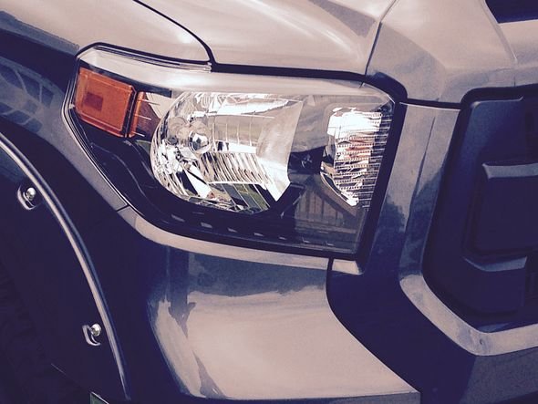

    Halogen use the amber turn signal for DRLs.

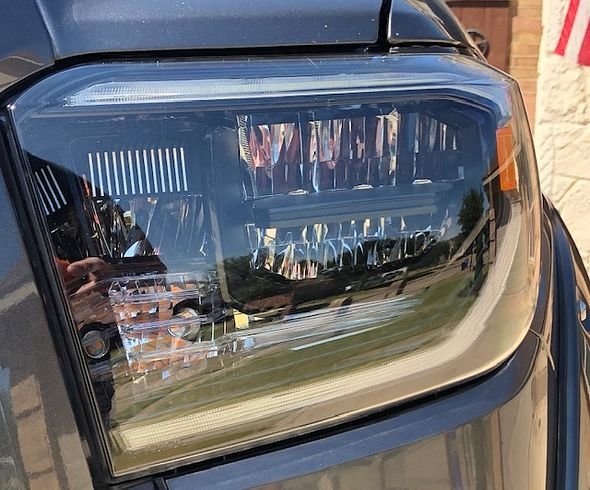

    LED headlights have the upper and lower white LED strips on the headlight.
    Halogen

    LED

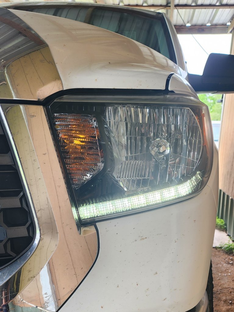

    20250404_172027.jpg My '21 SR5 has auto headlights however they are halogen with LED lower strip DRL.

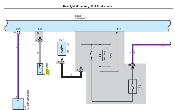

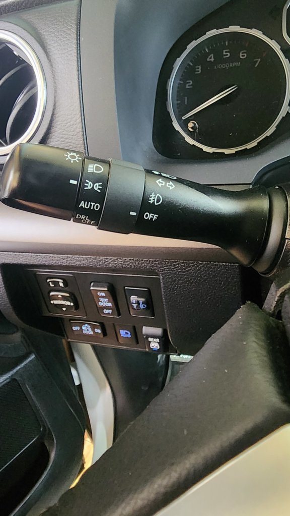

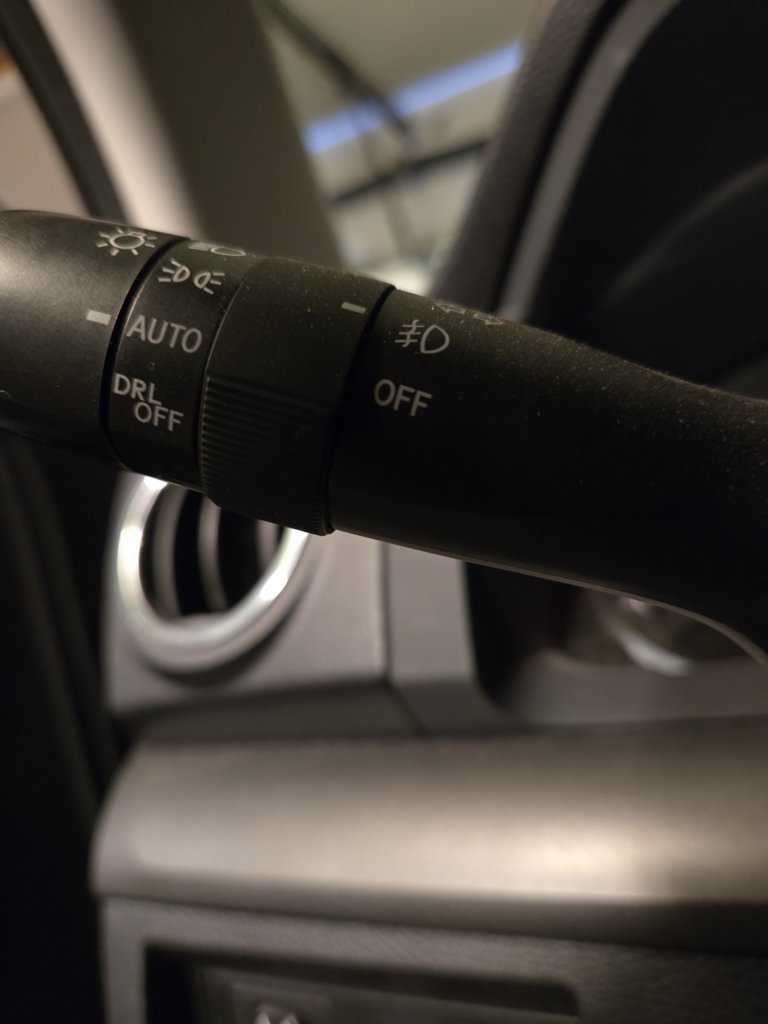

    Sorry guys... I have the Halogen with LED strip at the bottom. The DRLs work on the setting in pic below. But not in AUTO. I'm guessing the other side is not sending the ground to pick up the coil for DRLs. Is there anywhere I can locate that pink wire going to 3H on the ECU? I'm not very familiar with this. Is the 3H a wire number, pin number or harness number?

    Here's a better pic of circuit

    Update guys. Another guy in a different group suggested checking the radio settings under lighting for for the DRL to be selected to ON. That was it this whole time. DRLs work in AUTO now. I never thought that was a setting, learned something new today.
