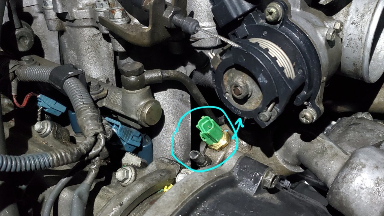

    Hello I have a code on 2000 toyota tundra po115 for ect sencer. Does any one have a picture of were this sencer is located tha k you

    Worth noting, both of those are coolant sensors. The green one is for the ECU. The grey/black one is for the gauge cluster. I believe the code is tied to the green one either being unhooked or faulty.
    @Iamtrawk this is one of those parts where you really want to stick with Denso brand. Don't use any old sensor they carry at the local auto parts store. And DO NOT order it on scAmazon or fleaBay. You'll likely get a fake. Order from Summit Racing, Rock Auto, or similar reputable place.
