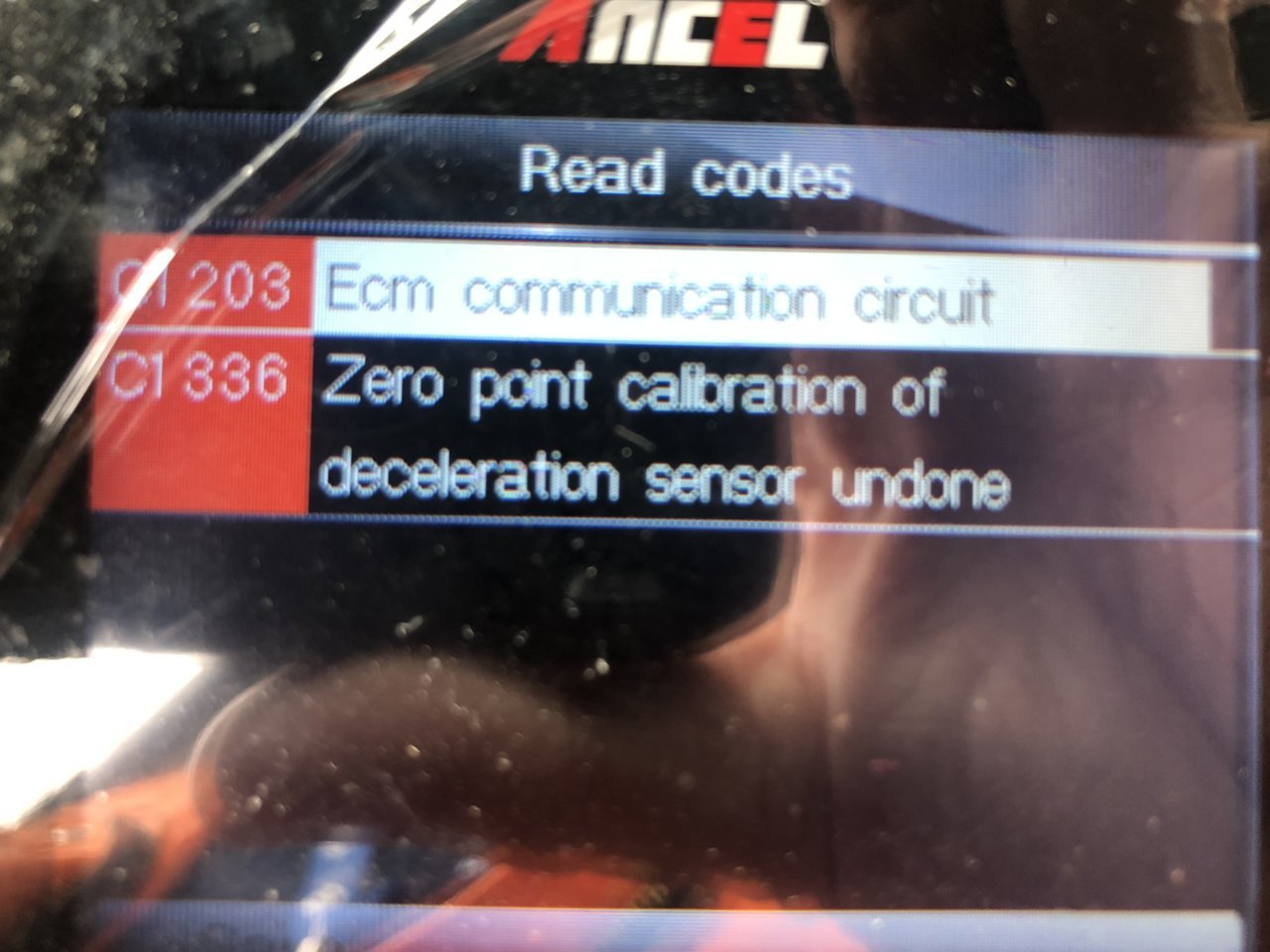

    34033866-0B58-48DF-8943-4211B06F9ABE.jpg No remote start ..truck is stock.. theses are the codes

    got it fixed now...did a zero point calibration and worked great... thanks for the replies
