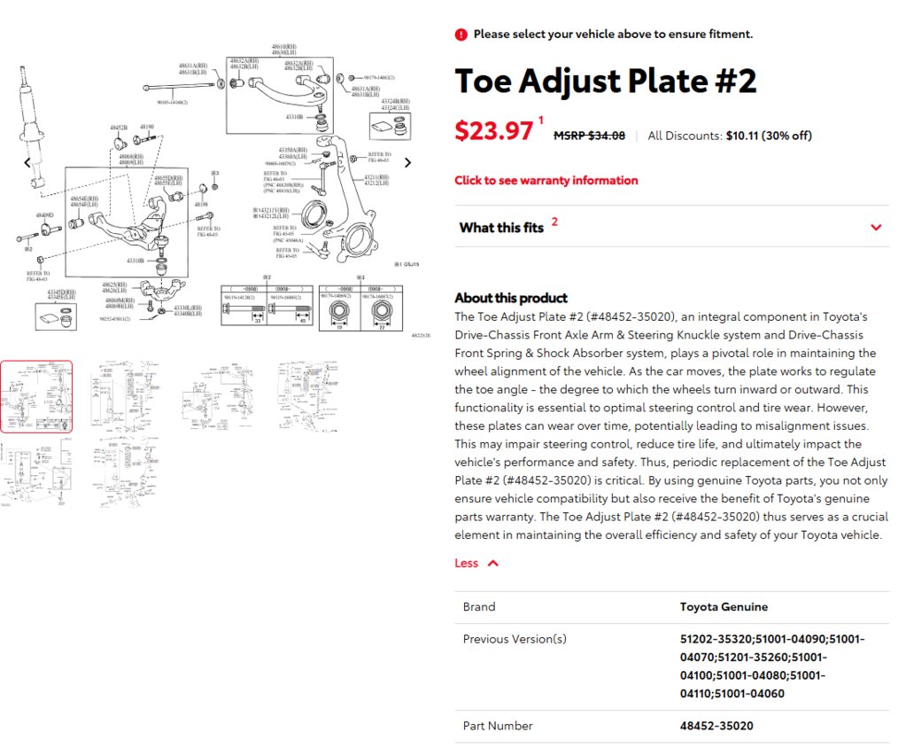

    nothing, ofc, I actually need it all..the bolts, the sleeves, the eccentrics...i didnt have 227.00 for tha
    Hey man, in my ignorance..i thought maybe "esscentrics" referred to the whole kit...sleeves, bolts, eccentrics. I det wouldnt balk on 23$ oem part but I know the whole kit is like 1/4 grand so I was just seeing if anyone made something solid that was half the price.

    Is none of it reusable?
    You just missed the 4th of july sales for discount on OEM parts. If you're not in a rush I'd wait for another one to come up. Probably around labor day.

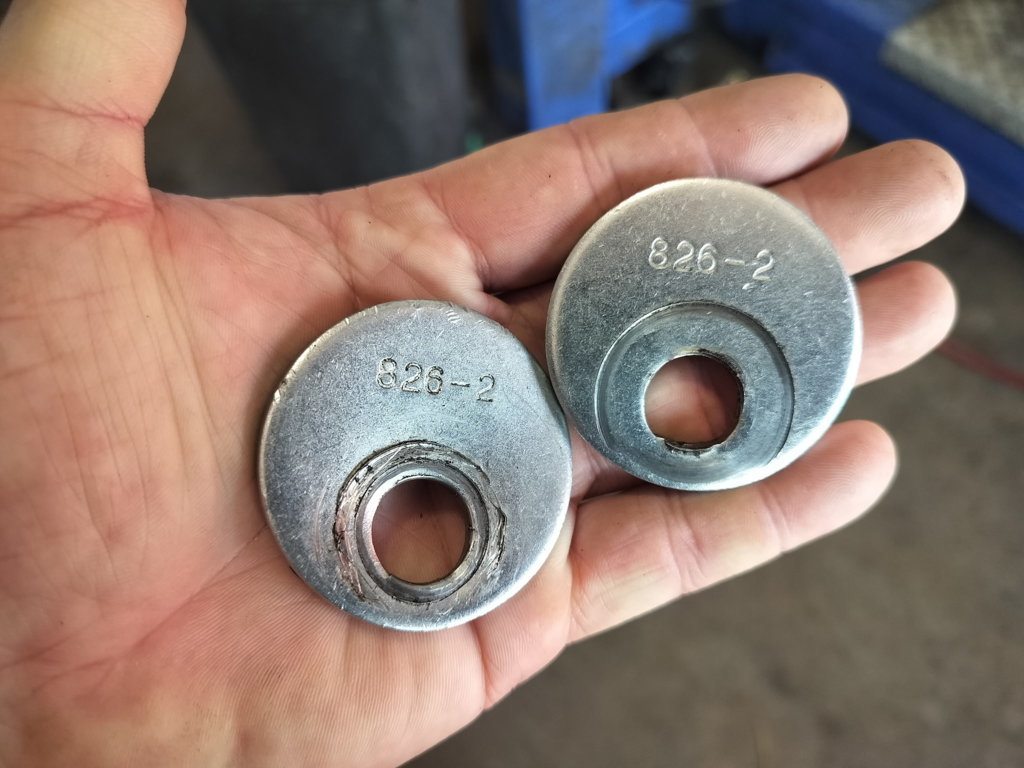

    Dont get the moog kit. I think this dude said he hit a pothole, and it just rounded out the D-hole.
    BroHon likes this.

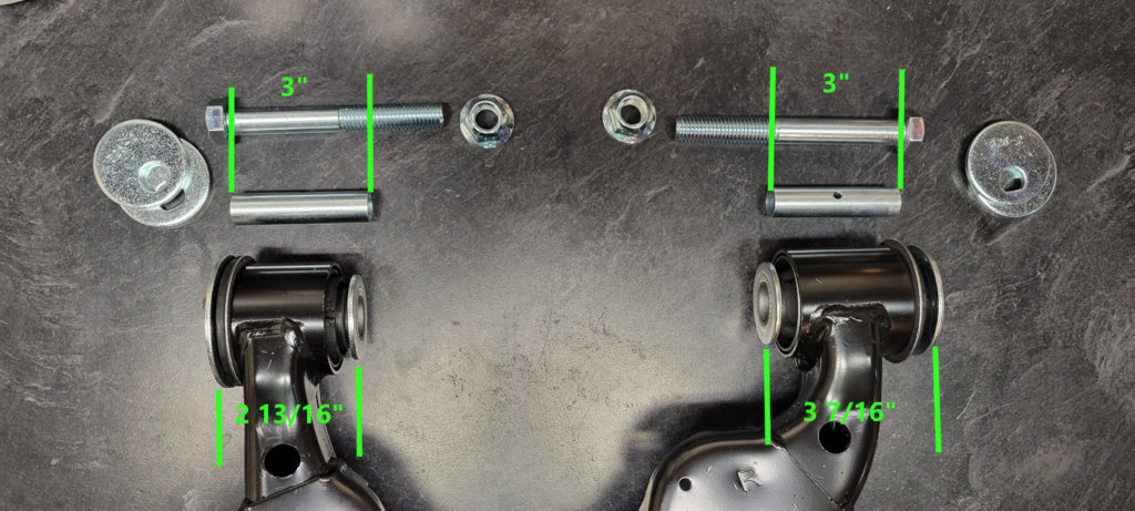

    I ordered the Moog, and the inner bushings were incorrect for my 2000. I ended up fabricating my own bushings with a stick of carbon steel tubing.
    I haven't had an issue with the D-hole blowing out (yet), or the cheap Mevotech control arms I used, but I haven't worked the suspension hard (yet) either.
    At the time I was pretty broke, so it was the only option. I'd do it different if I had to again.
    Not precise caliper readings here, but you clearly get the picture they are wrong.
