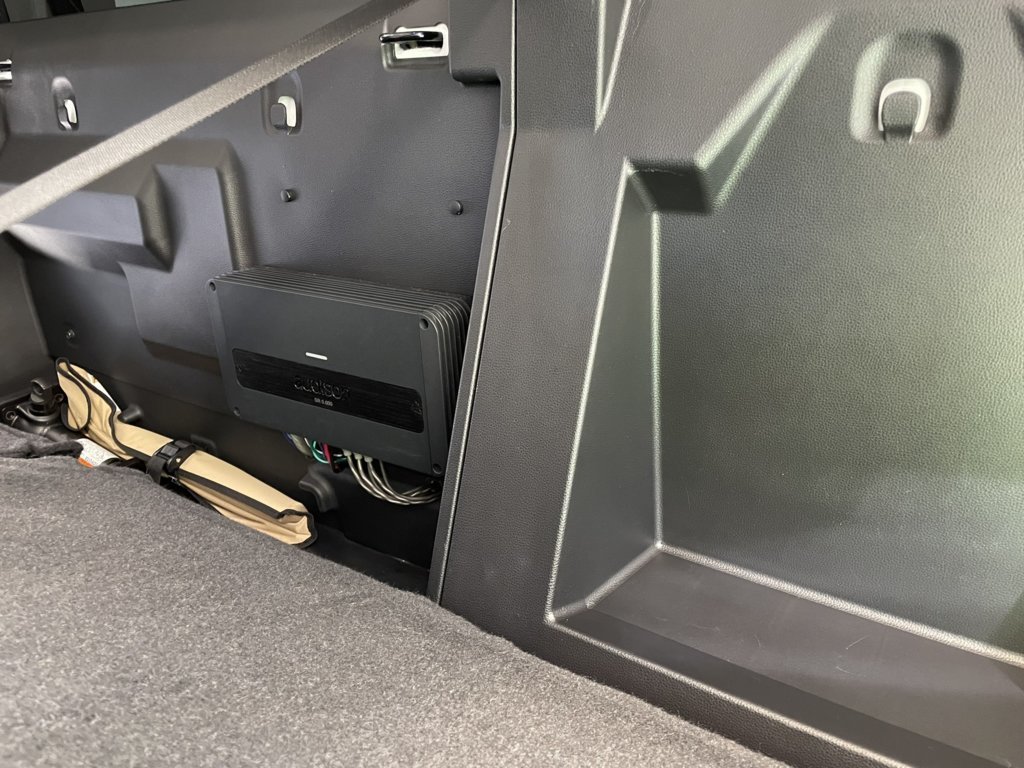

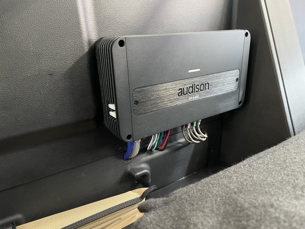

    I'm connecting my entire system with the TacTunes wiring harness set. The first harness runs the stock speaker signal all the way to the rear of the truck where they will plug into the inputs on my amp. Then the second harness runs the amplified outputs back up to the OEM harness behind the dash and then out to the speakers via the OEM wiring. My 5-channel amp sums the 4-channel OEM signal to build the separate sub-channel output.
