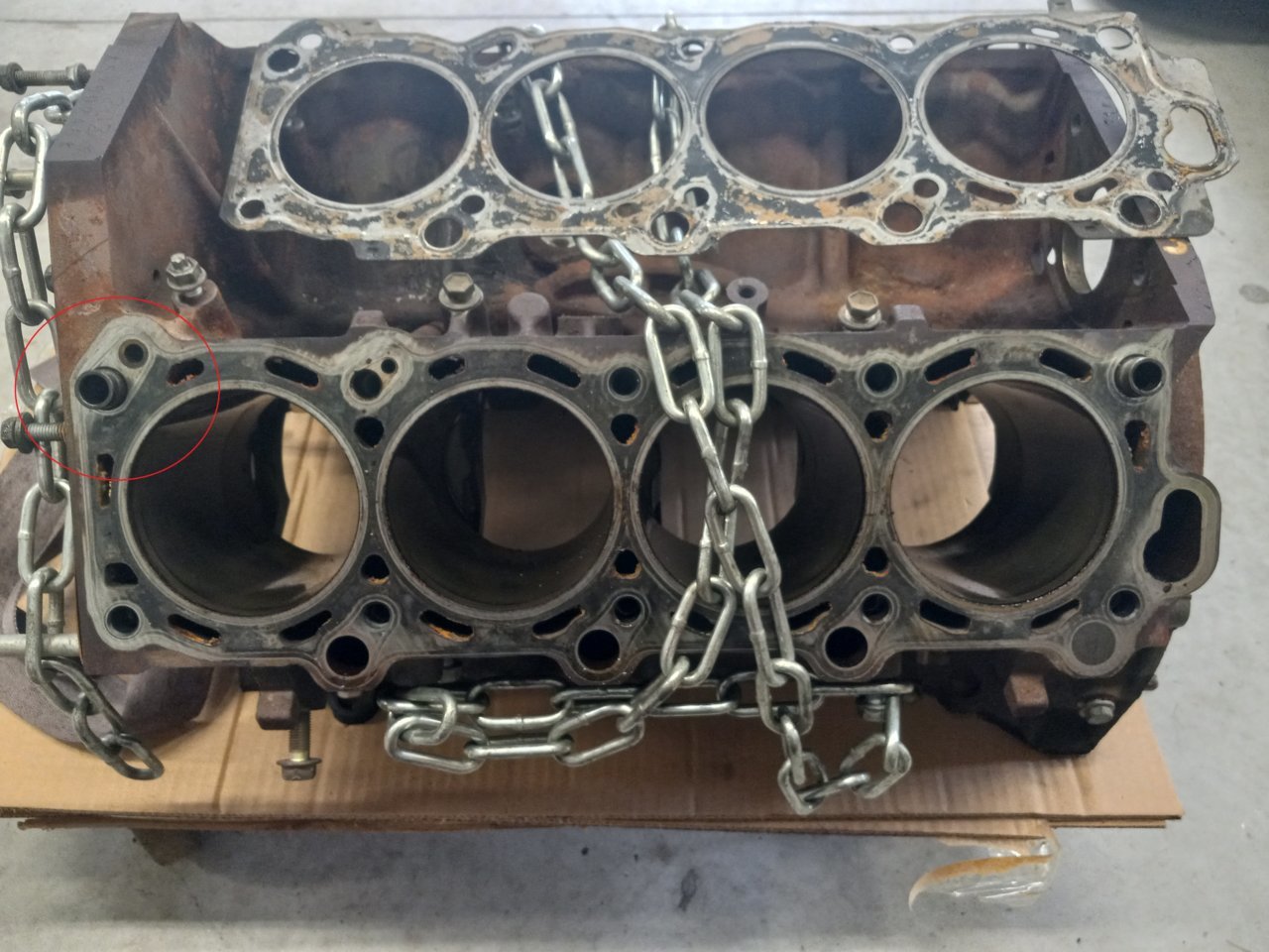

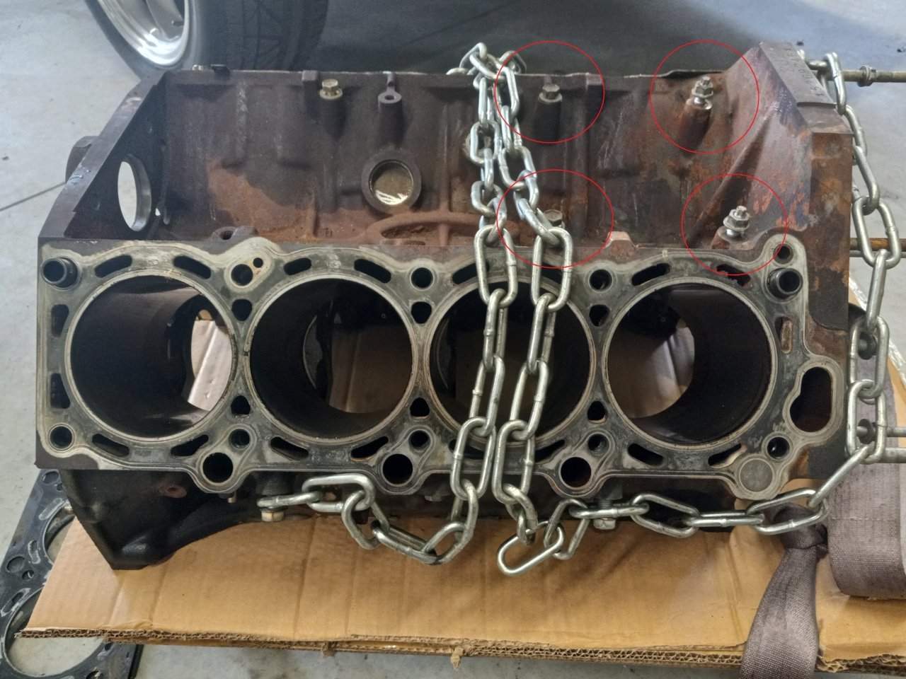

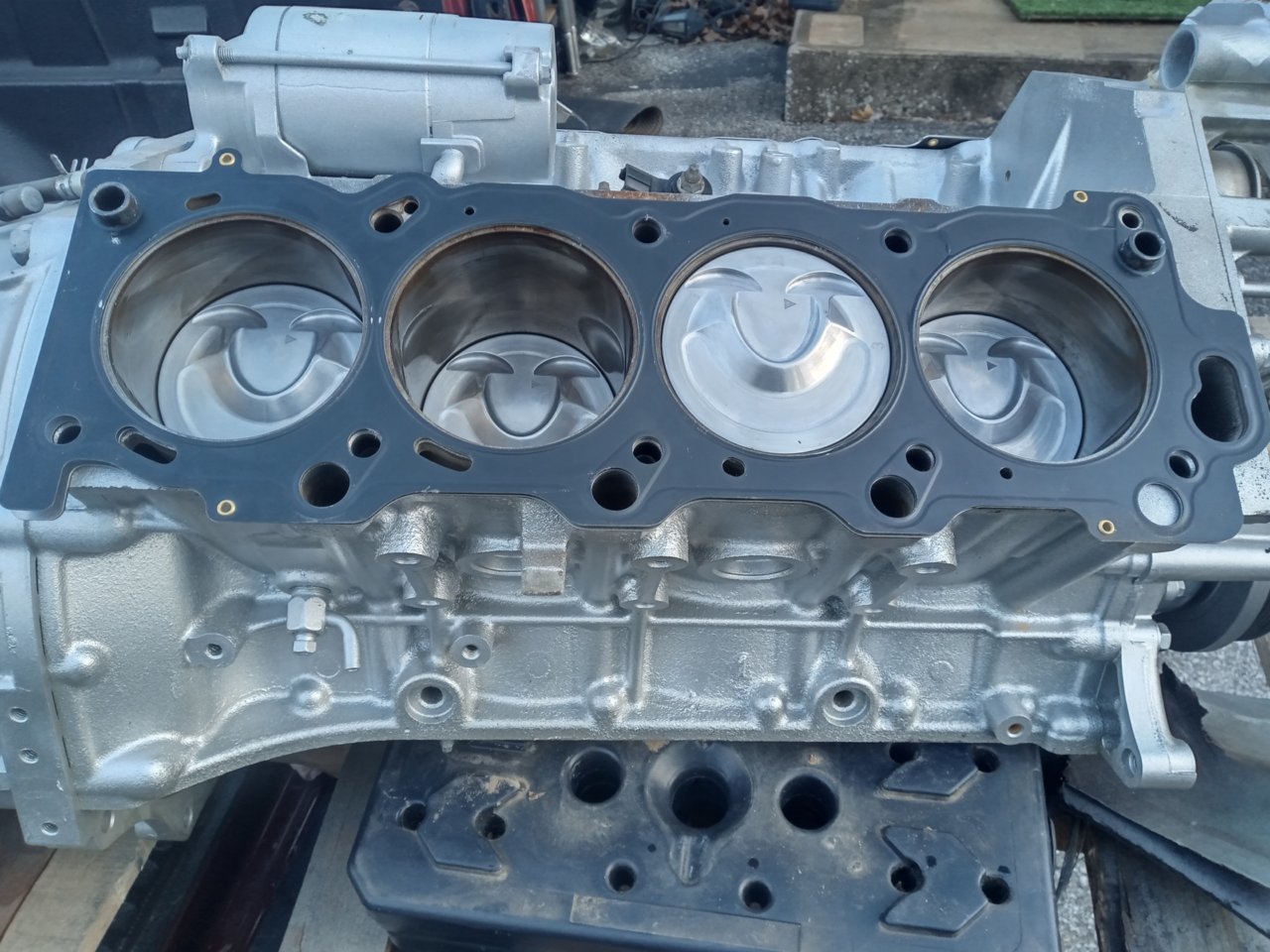

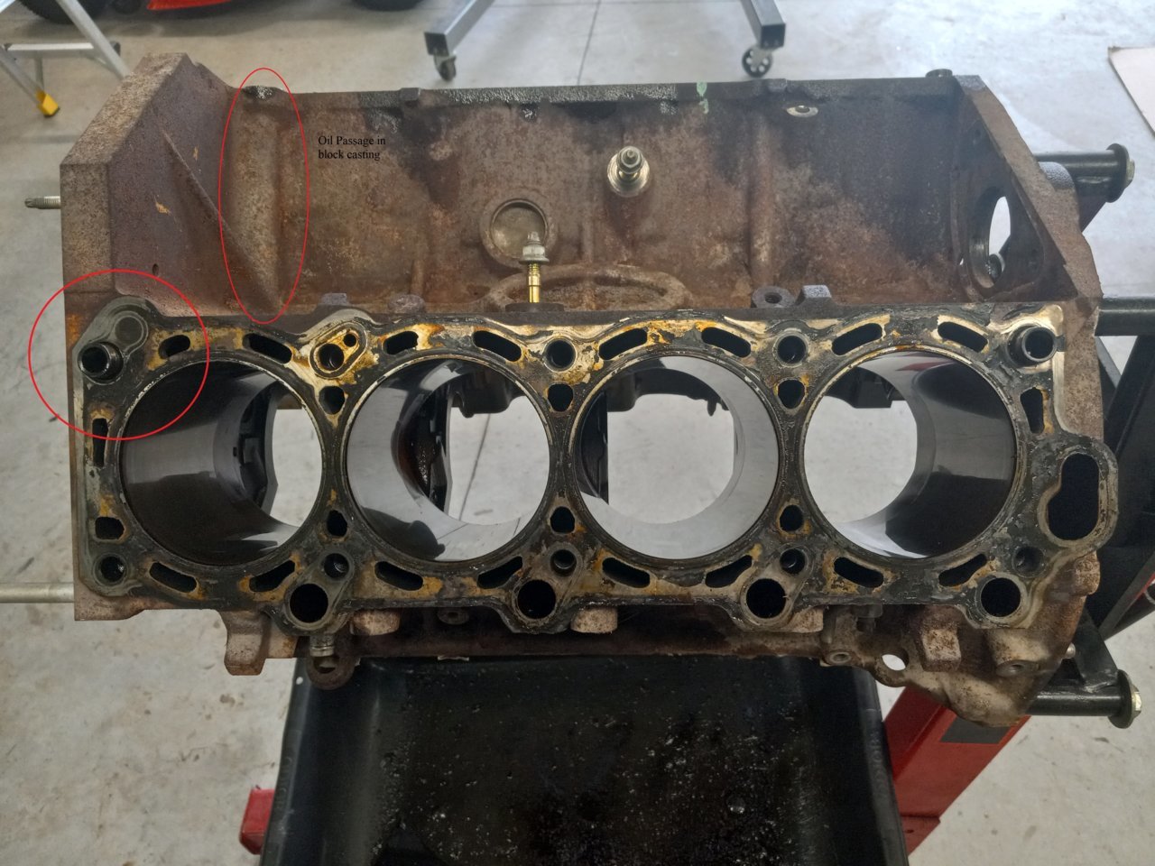

    It's been a couple months, but @empty_lord is correct. The two blocks are nearly identical except for 2 small differences as it turns out. Theoretically you could use a non-vvti block with vvti heads, but you would need a good machine shop.
    The oil passage that feeds the vvti components on a vvti equipped engine *exists* on the non-vvti blocks, but it was never drilled out from the factory. The heads gaskets are identical. You can literally see the oil passage in the block casting that goes from the deck to the main oil galley in the center of the block. You would need a machine shop to drill them out (prob not worth the effort). See pics below.
    The only other difference is that the vvti blocks have additional mounting points in the intake valley where the secondary air injection system mounts. These don't exist on the non-vvti blocks. Starter and knock sensor mounts are identical.
