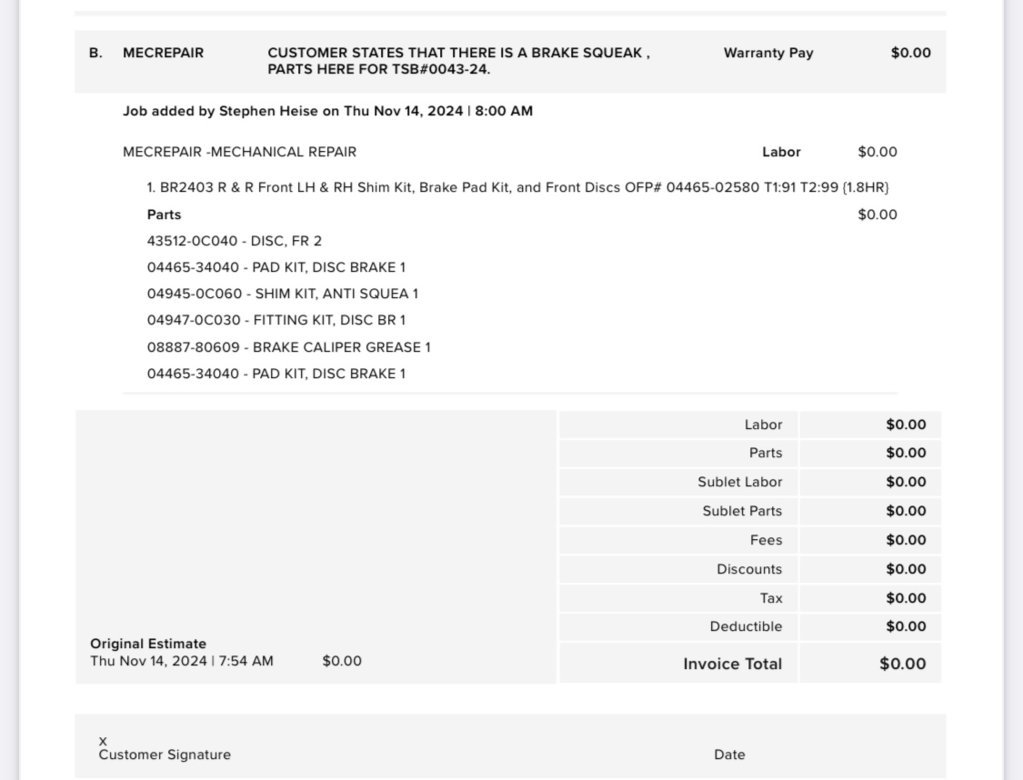

  5. Nov 18, 2024 at 3:12 PM
    Timmy23
    Timmy23 New Member
    Dec 10, 2022
    #88288
    373
    OR
    25 1794 MGM Tundra
    None
    Here is mine
    Tundrastruck91 likes this.

    Im scheduled for an 11/26 820am appointment next tuesday. They stated:
    -we do an inspection
    -submit the claim to toyota if warranted
    -if approved, they order the parts and sch brake job apptment - stated it takes about 2 hrs
    Is there any reason they would not approve it? The noise will not happen when I bring it, so I guess they are looking for wear on the rotors or damaged pads?

    I told my dealer about it when I went in for the fuel line recall. I had the TSB printed out and on the passenger seat.
    They said they would confirm the squealing.
    When fuel line was done they had ordered the parts kit for the brakes and they would call when parts were in.
    Took 2 weeks or so to arrive and then schedule the repair.
