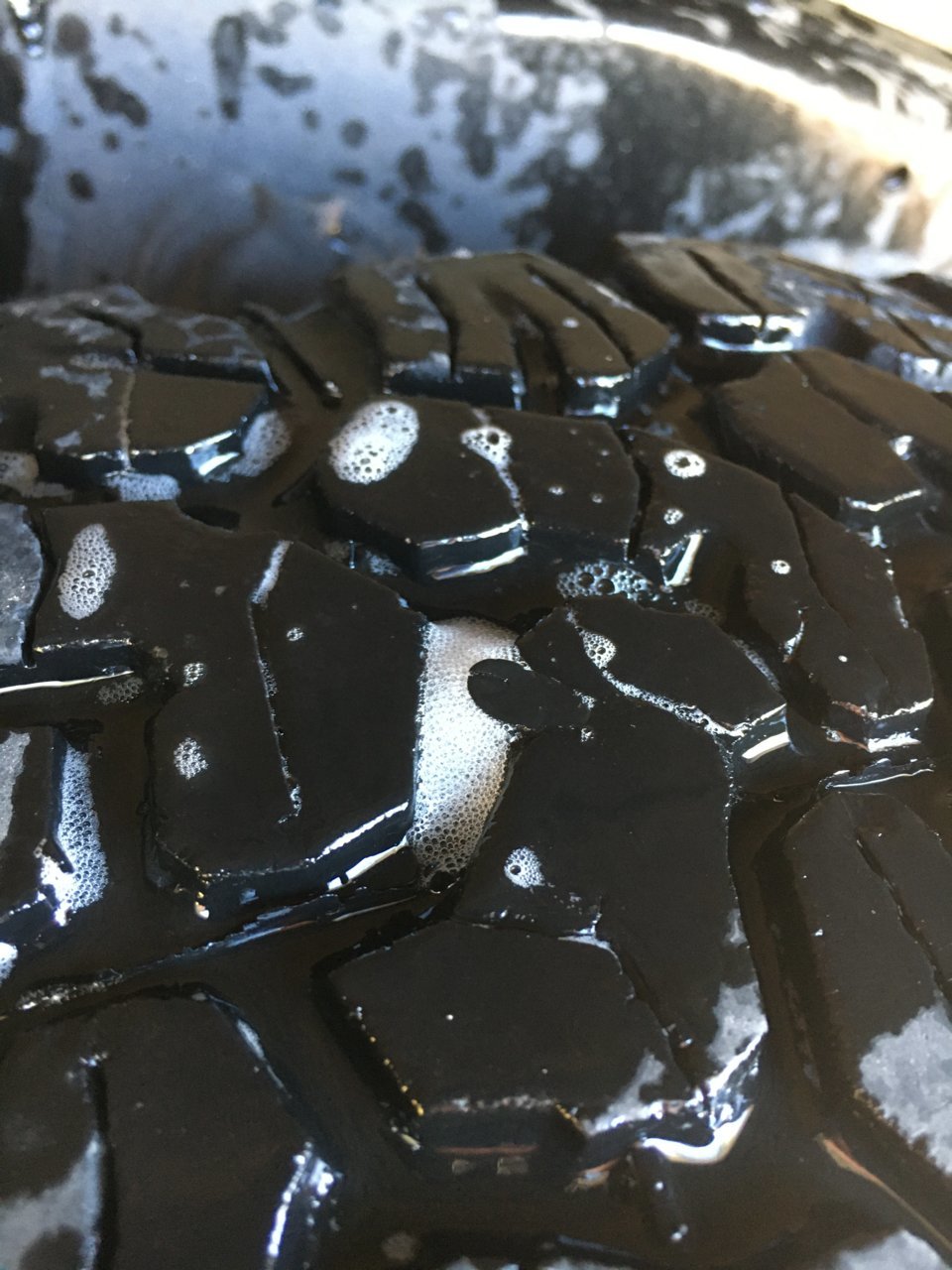

    Not ko2 specific, but runner has had the Tpms light go off on momma bear, discount filled twice now, so finally I took a stroll around
    Wah wah waaaaaah

    You don't like your tires to blow bubbles? I think it's a neat trick
