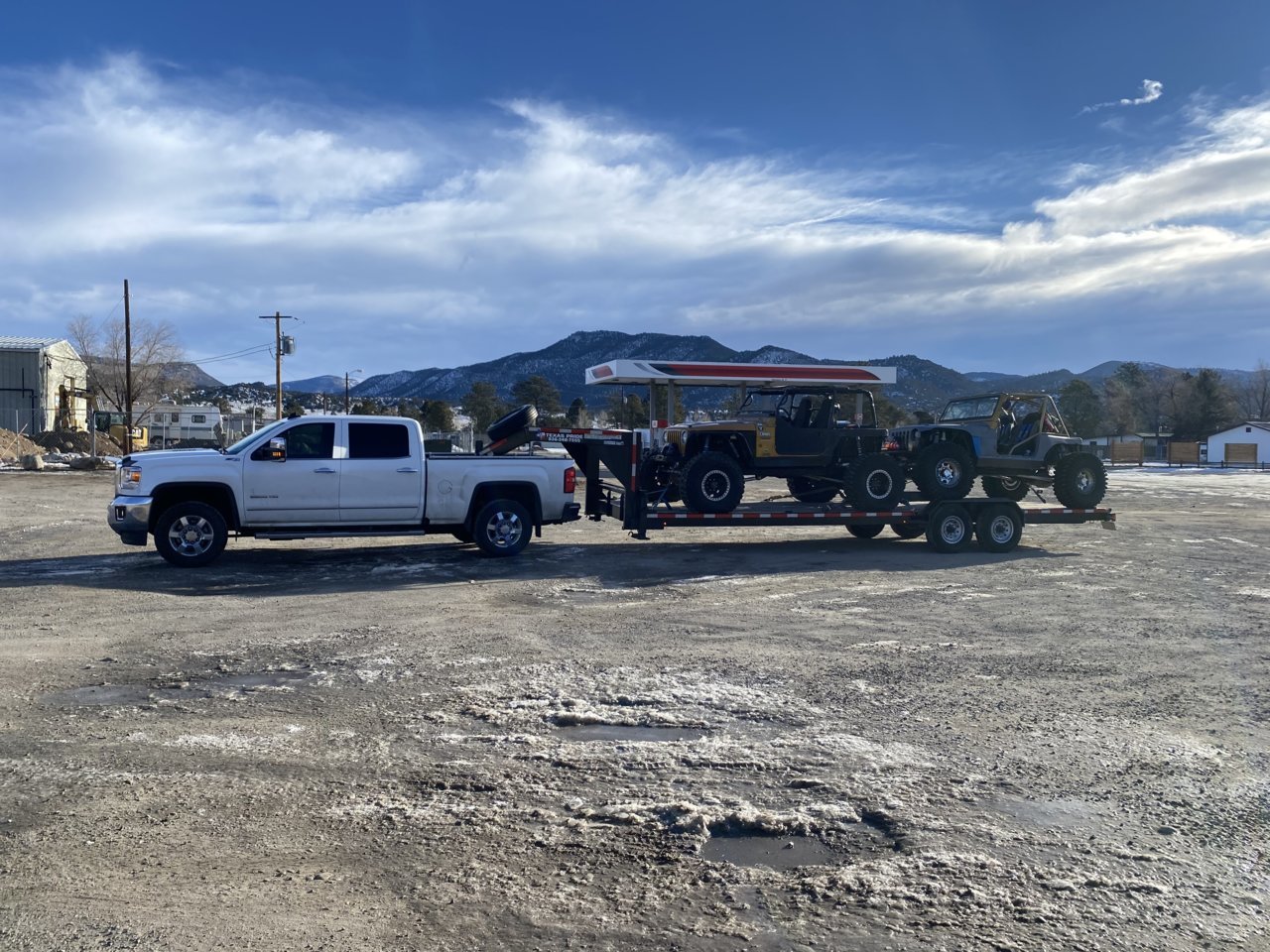

    E rated tires are for this:
    Not this:

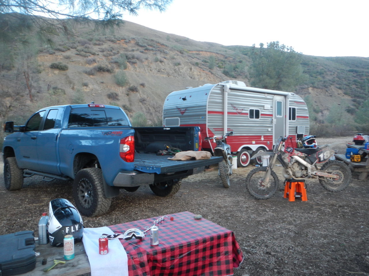

    With 2 dirt bikes, 20 gal of fuel for the bikes, firewood and everything else that goes with camping in the bed, then the trailer. Why not a heavy rated tire?

    Are you overloaded then? What kind of trailer?
    Two dirt bikes= <500 lbs, but just under (assuming you have thumpers in a 450)
    Gas= 124 lbs
    Wood= let’s get real here. 100 lbs of wood goes a long way and probably couldn’t fit it in with the gas and bikes.
    So we are at ~700 lbs. Now add two guys at 180. 1060. Hope your trailer tongue weight is under 340 lbs. (doubtful)
    So let’s get back to the tires.
    OE tire. Load index 114. That’s 2601 lbs each. Quick math 2601x4= 10404 lbs. this exceeds any tow rating of a Tundra.
    41 lbs each is pretty decent.
    https://www.discounttire.com/buy-tires/michelin-ltx-a-t-2/p/17938
    Now let’s get over to a LR E.
    Now you are adding 7 lbs per wheel in a load index 121 tire..which you can now add to your already overloaded weight. Each one of those tires are rated at 3197 each. These are for older 3/4 ton trucks. When I had my tundra, I couldn’t find any P metric at the time and put LR E BFG KOs on in a load index 124 (exactly what I have on my one ton). I noticed a drop in fuel economy, longer braking, and slower accelerating. These tires were around 53 lbs each. So 12 lbs heavier per tire.
    You can see where I’m going with this right? You are either overloaded or not. Sounds like you are overloaded. Could be wrong though but would need specs of truck, trailer, and cargo.
