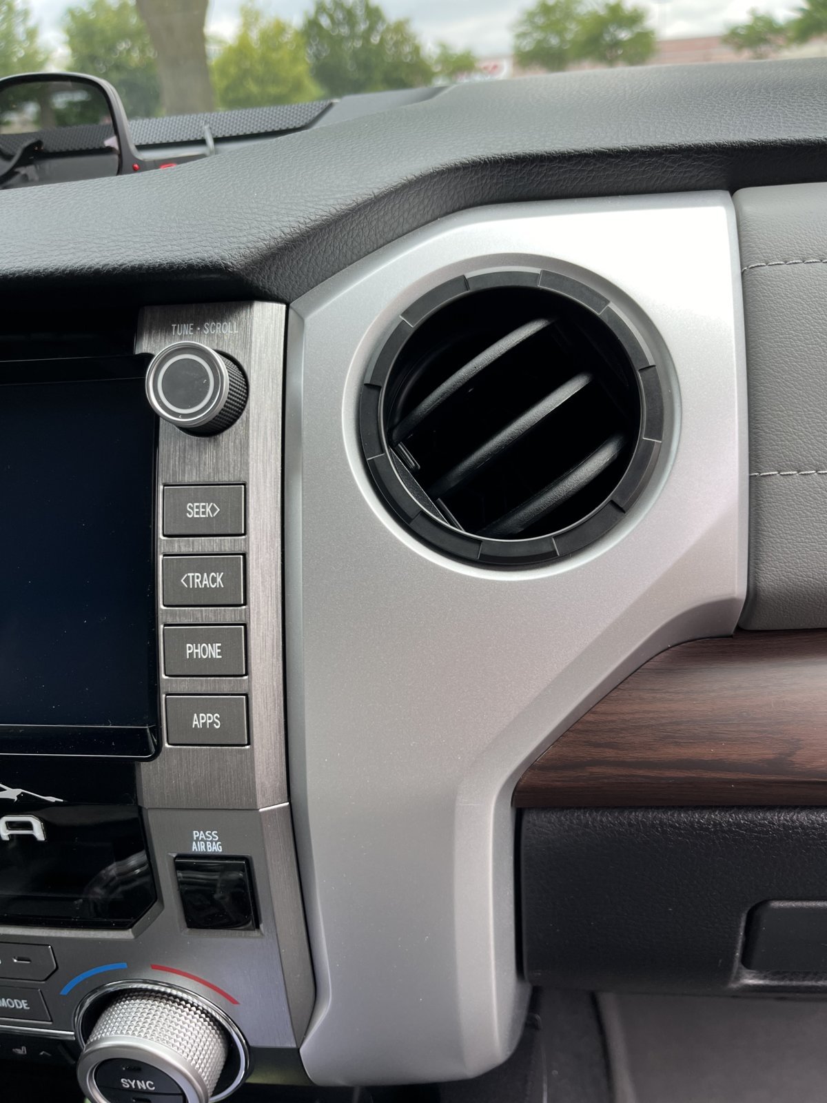

    So my wife was trying to help by putting an air freshener that clips to the vent. Somehow she pushed the clip that holds the air freshener to the vent past the vent and it disappeared. I checked if by chance it went down to the cabin filter but it didn’t. All controls work no noise or rattle was noticed. This is the vent location. Am I ok to leave it or will this cause issues ? Thanks for the help.

    ^ this, those panels to the right just pull off.
    There is a honey comb type thing behind the vent.
    You could try something like this and stick it down there and try to grab what fell in if it will fit.
    Bendable Flexible Magnetic Pickup Tool, 24'' Four Claw Grabber Tool, Accurate Pick Up In Narrow Space for Engine Bay/Home Sink/Drain/Earring/Keys/Metal Objects (Magnetic orientation) - Amazon.com
    If your OCD goes crazy and you feel the need to pull the silver surround, all this has to come out to get that surround piece out.
    Maybe not so much the console parts tho..

    Do you have to take the dash apart to remove the vent and honeycomb piece?

    As bad as the picture looks @1lowlife provided. It's not horrible.
    Edit: I would try the grabber tool or something similar before I tore everything apart.

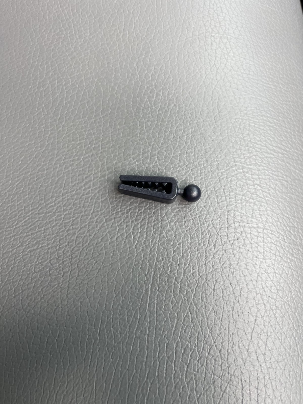

    Thanks for the help guys. Once I got home from running errands I closed all my vents including the rear with the exception of the one with the clip that fell down inside. I then turned the HVAC on high. At first it didn’t rattle or bounce around so I tapped the dash and it started bouncing around again. I started to cut strips of cardboard to fit in between the honeycomb grid but before I could put any in the grid, it stopped bouncing around again. I tapped the dash again but I still couldn’t hear it bouncing around. Then I looked inside the vent and it was just sitting there waiting for me to remove it.
    I am so glad it was this easy and didn’t require removing the dash. I truly appreciate all the help and advice.
    This is the piece that caused all this trouble. About 1” long.

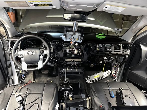

    I'm just curious, not judging or trying to be smart, but are you going to keep using those? I like air fresheners too, but have avoided the vent style like that because I had to tear apart a RAV4 dash due to my daughter letting something get in there that made its way to the blend doors and jammed one (actually it broke it). What a nightmare that was.

    I thought this was ironic timing; this video just dropped today and is appropriate for this thread. This is very similar to what I went through on the Rav4 I mentioned. I DIY'd it and had the entire dash pulled out/apart. Replacing the unit that had all the servos and blend doors was around $1500 and that was 9-10 years ago, but I rigged up a fix that was less than optimal but waaaay less expensive. It was several days of frustrating work since I'm not a trained professional like these guys. No one was more amazed than I that it worked after I got it back together and there were not rattles or squeeks. https://www.youtube.com/watch?v=VWNBgfXgp0Q
