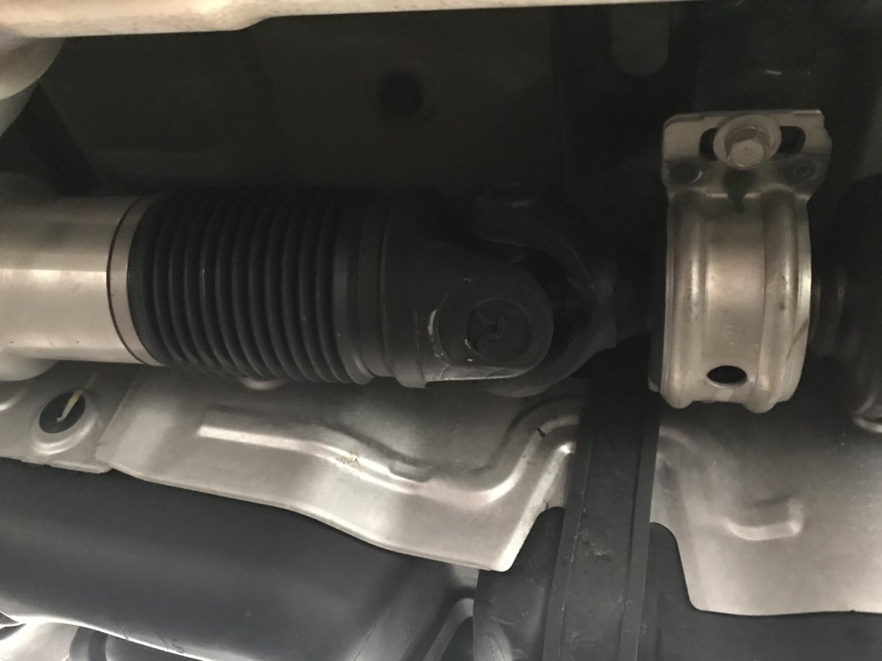

    ABABFD0C-F9D4-4609-BB7A-DDDF31ABE742.jpg D1181761-3DCF-45D1-B474-CEDD48FFC038.jpg Forgive my ignorance, I want to get it right. I assume that these are going to be the only two slip yokes? One on the rear shaft and one on the front?

    For our trucks, yes, you are correct.

    Those are indeed the slip yokes, but they are sealed and have no zerks to grease.

    Okay thanks, the zerks on or in the joints adjacent to the slip yokes are strictly for the u-joints?

    Yes. Grease them until you see fresh grease coming out. That’s what I do. After the initial grease the first time I did it, it only takes a few pumps. The first time it took quite a few to fill it up.
