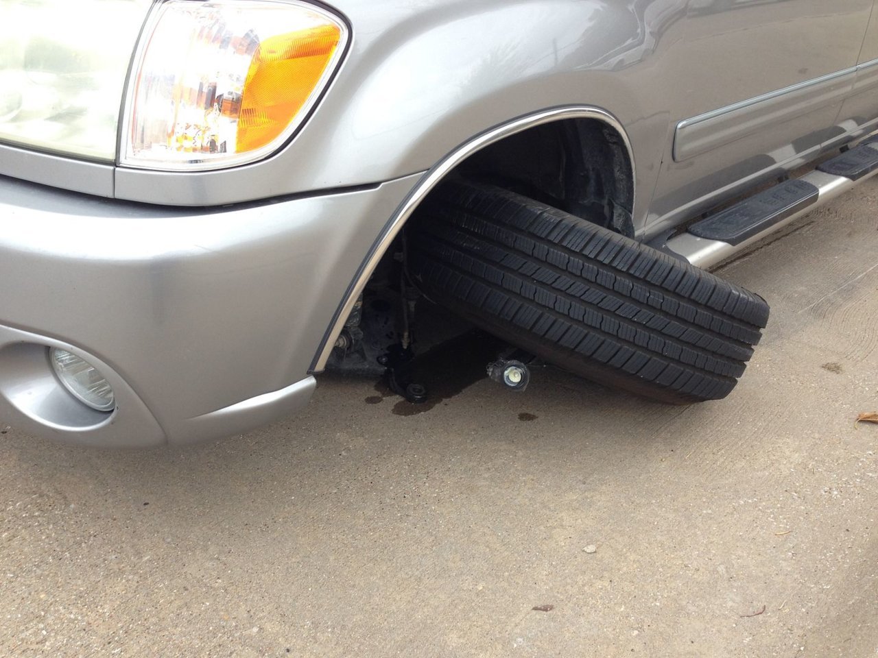

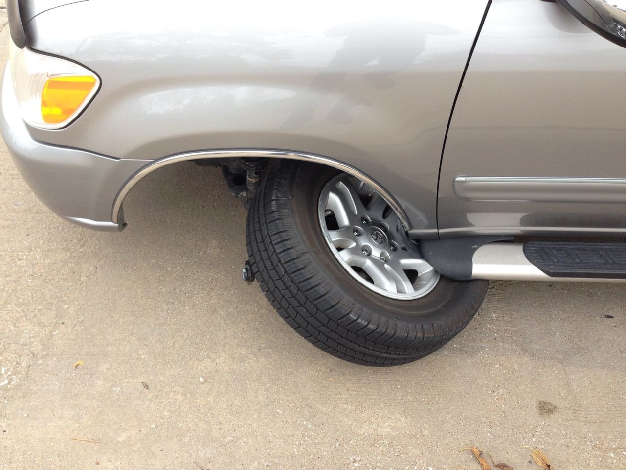

    You mean like this????
    Mine happened when NTB forget to put the cotter pin in the spindle going into the lower control arm.
    Nut came off and the spindle popped out while driving..

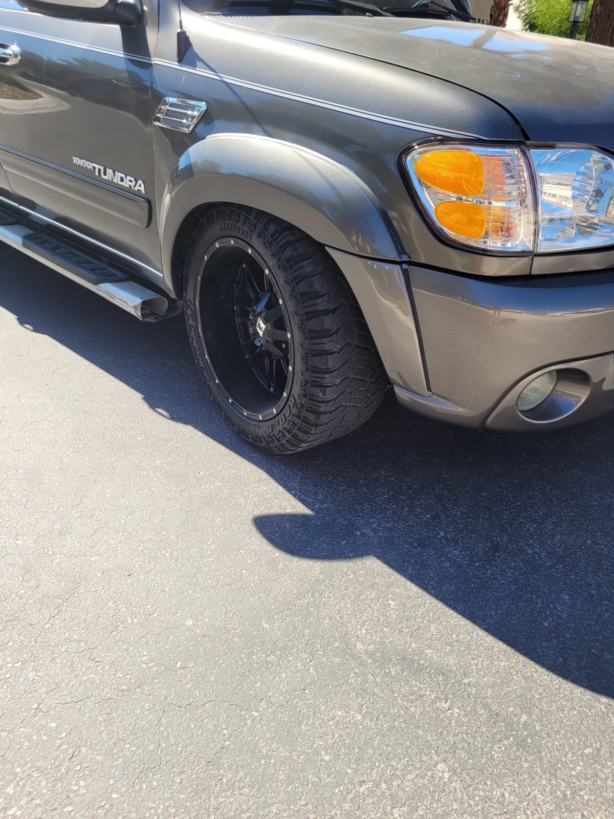

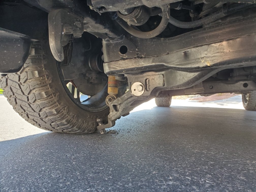

    Hi everyone. Just joined the LBJ failure club today. Shoulda stuck with my Chevy's IMG_20231015_143135.jpg IMG_20231015_124556.jpg
  21. Oct 15, 2023 at 7:35 PM
    shifty`
    shifty` Just like witches at black masses
    Jun 20, 2020
    #48239
    28,362
    ATL
    '06 AC Limited V8/4WD
    Former GM lifer here: GM has its host of problems. Let me guess: you missed the memo to only install OEM lower ball joints?
