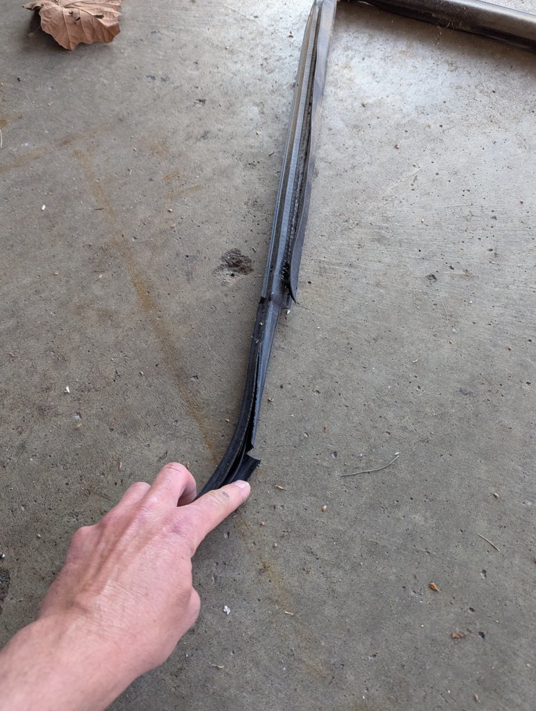

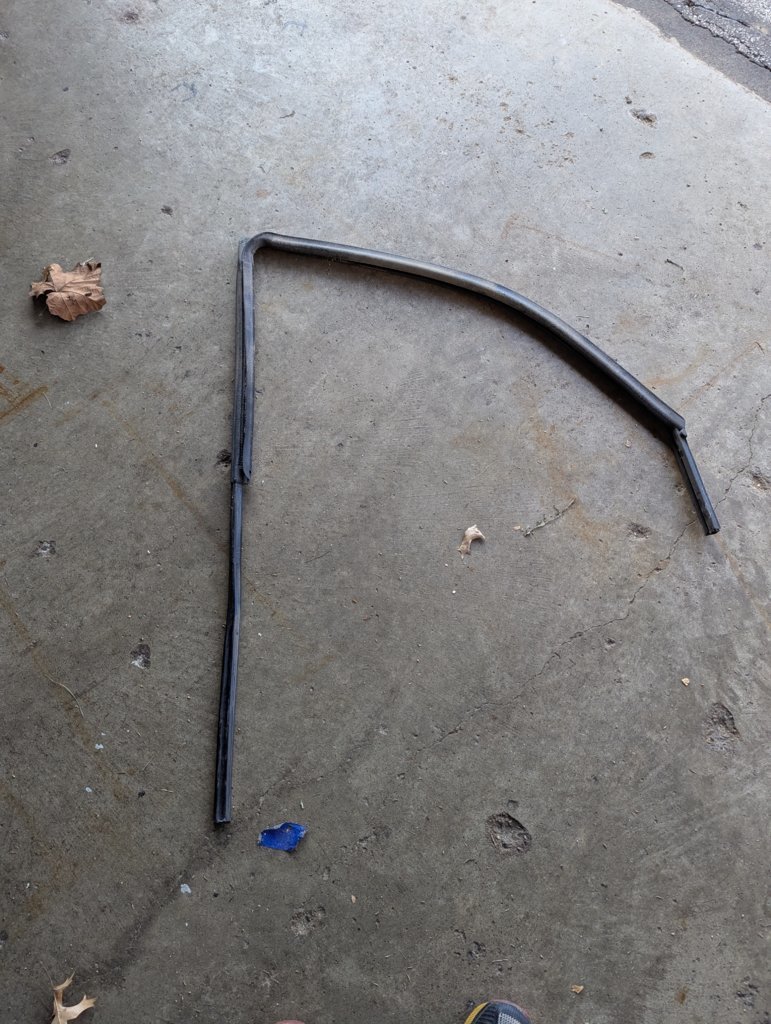

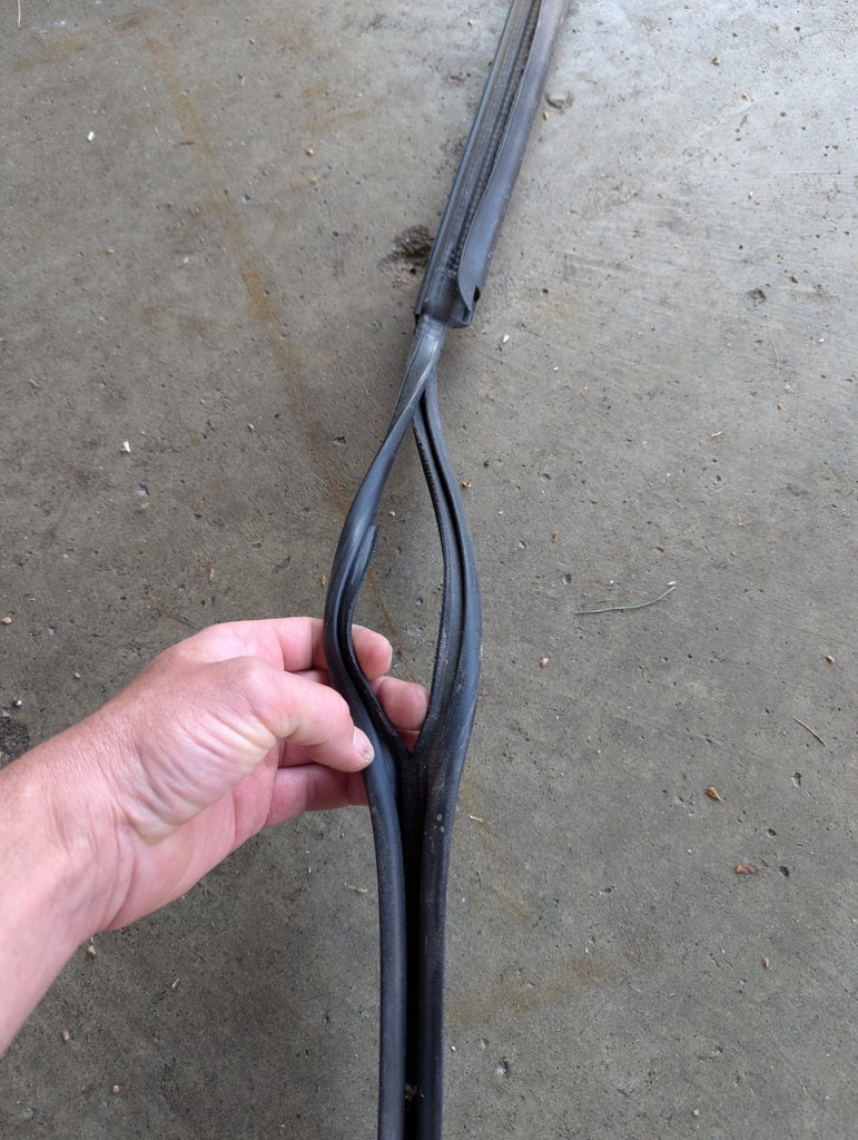

    Did you inspect the rubber window run? The rubber has a spot in the metal track. If it is torn, which you can't sometimes see if it's in place it'll cause binding on the way up. Gimme a sec I'll give ya an example of what I mean

    So this is what could be on the inside of the track causing resistance this maybe causing the internal breaker to stop the motor on the way up.
