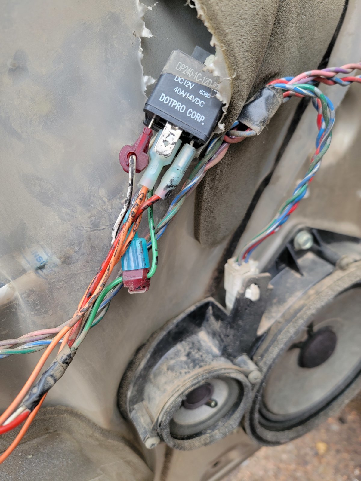

    Relays also. Here's one good example, if you need it, see here for more pictures in context.
    I remember this case also, wherein a wire was damaged/nicked, physically inside the door boot, where it wasn't fully visible.
