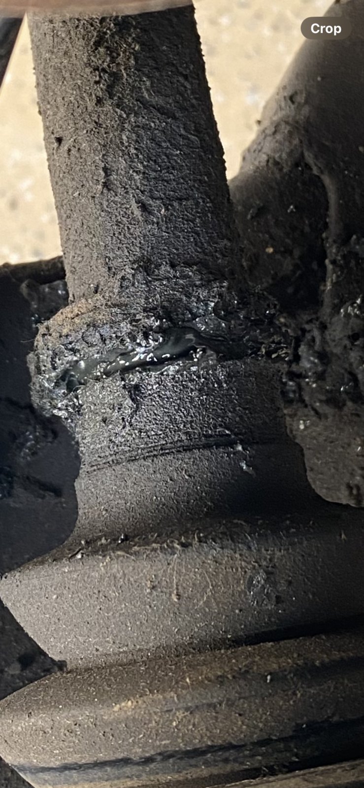

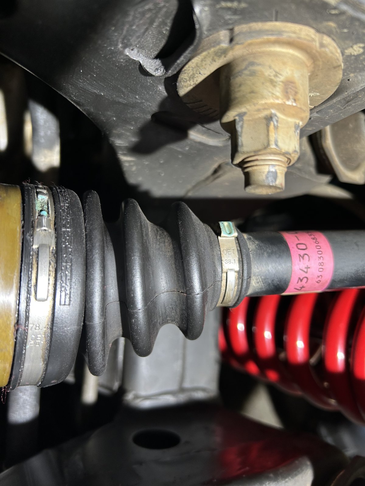

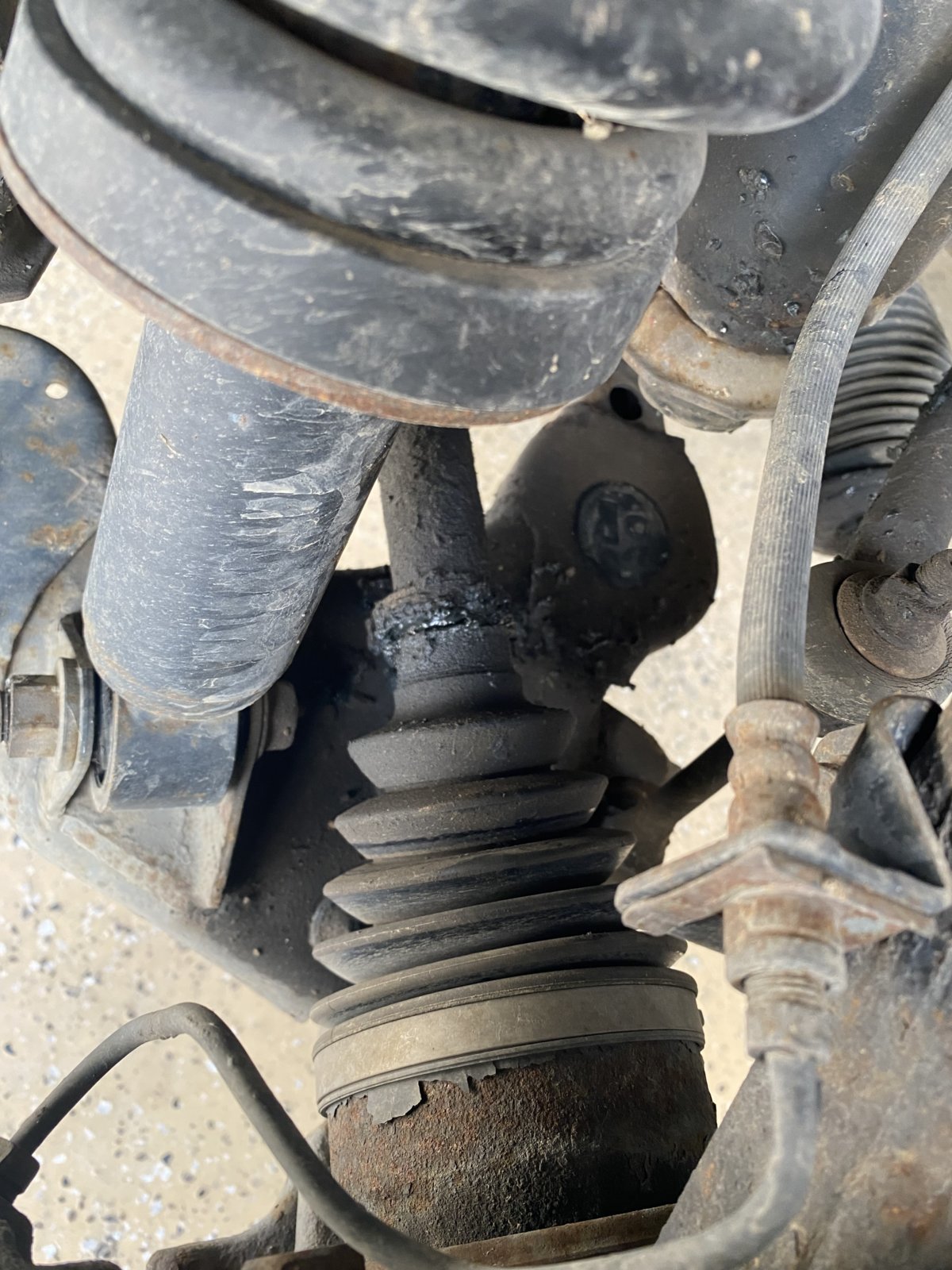

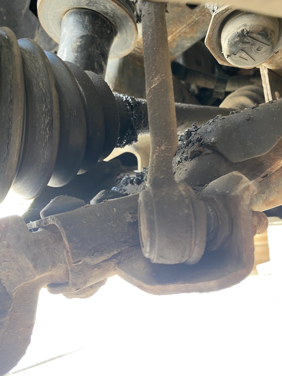

    Was about to replace my LBJ today but after getting my wheel off I notice my axle has a “clamp” failure on my outer boot, on the smaller end of the boot. Hopefully I make sense here, I’ll post pictures.
    Now I’m trying to decide whether replacing the boot with a boot kit or replacing the axle itself. There is a small noticeable “clunking” noise but not grinding when going over some bumps. Sometimes it happens and sometimes it doesn’t.

    Yes, Toyota is supposedly killing off remanufacture for the axle, all you can get is new. There are a few remans lingering at un-connected dealerships, and maybe they'll return to reman later, but for now, most dealers will tell you "remans are discontinued".
    First thing I'd do is clean that up to get a good view of what you're looking at. I agree it looks like the boot simply slid out from the clamp. But you need to clean up all the surfaces before re-clamping. The clamp you'll need is a 38.1mm Oetiker, which requires a special tool to install.
    This is what that should look like, on a nice clean OEM axle. Yours, I can't tell if the little high spot is still on the tip (just the tip) of your boot there. If it is, re-clamp is do-able.

    I'm kind of thinking that boot may have slipped and ripped itself in the process. I'd probably be looking for another axle or rebooting this one, but I'd be tempted to zip tie it in the short term.

    Looks like you may need a replacement clamp if inot ripped but may want to dissasemble, clean, and refill with grease. There is a detailed writeup and video for the inner boot with OE boot kit part number including grease and clamps folks usually consider if not lifted, and aftermarket if lifted. Once have the inner off can pull the outer too. Videos around for that too.
