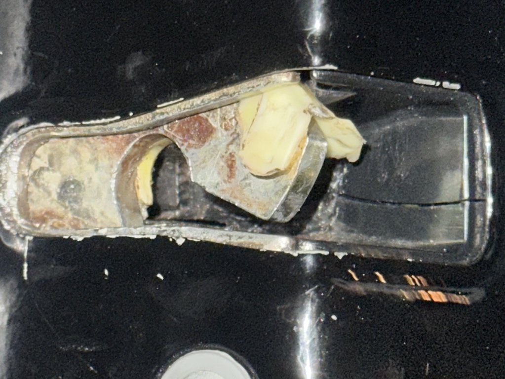

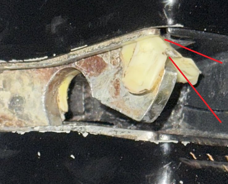

    Going to attempt to bring this post back from the dead.
    I have attempted lubing and have damn near gone through entire can. It's helped, but nowhere near solved the problem. I'm thinking that it may be this piece of rubber/plastic that has been ravaged and now just hangs on for dear life. My next step is to cut this out, spray lube like a madman again, and hope it's solved. Currently, the door will not shut without me manually pushing this piece up.

    I swear there is at least one more thread discussing this plastic bit inside the door latch mechanism. I just couldn't find it.
    I've seen doors with and without it. That said, if it were me, I'd probably get a pair of needlenose, and grab here, pull as much out as I can. I suspect it's getting jammed up in the door. I reckon they probably skinned this in plstic for smoother operation, and rattle reduction.

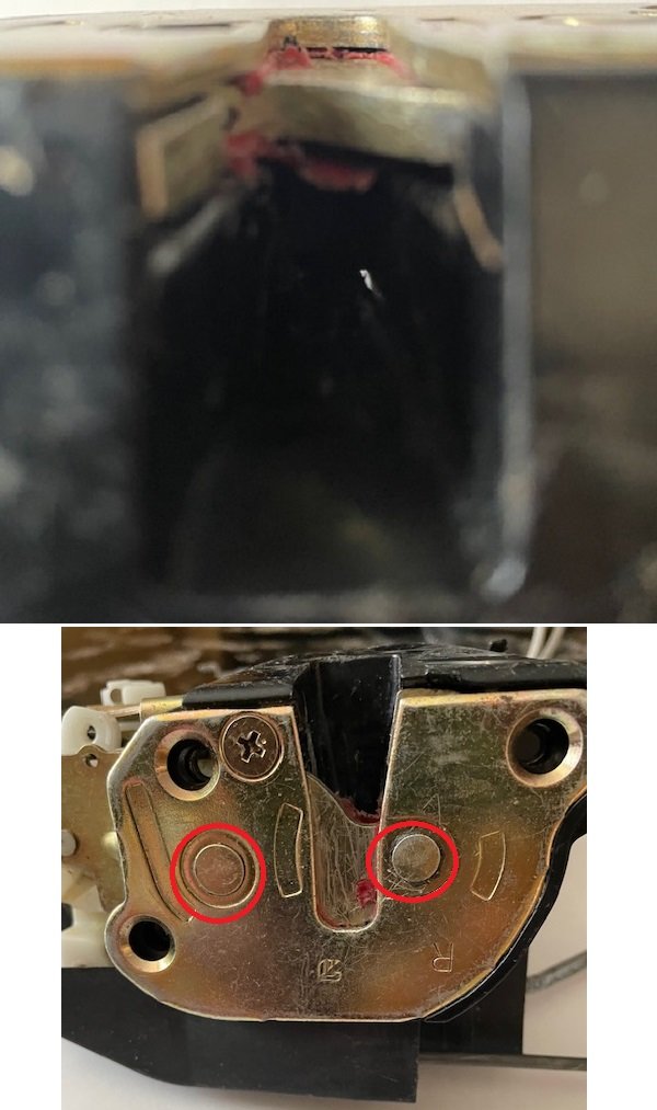

    Not being a nega nancy but good luck with that. Took great pains in attempting to remove all that plastic(mine was red) on drvr door. I moved the exposed latch CW as much as it would go, cut plastic with exacto knife, rotated CCW, cut plastic but since plastic appeared to be wrapped around whole piece, it seemed futile. My last step was to remove the 2 rivets circled below but the bulldog in me said the hell with it at that point. After 20 yrs it had seen it's better days and new one from Ourisman was on front step in 3 days.
    Good luck tho

    Yup, I tried removing it and was able to take off about half of the plastic. I sprayed it with lube a good bit and it seems like it maybe helped some, but it still sticks down a little and needs to be manually pushed up.
