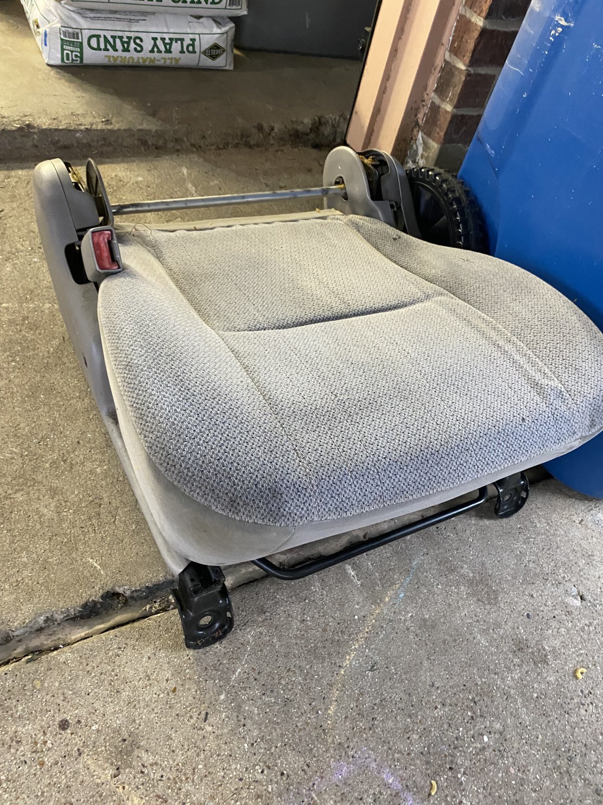

    I took my (non-power) seats apart last summer. This is the only pic i have of it. Perhaps you can glean something from it?
    455h0le_dachshund[OP] likes this.
