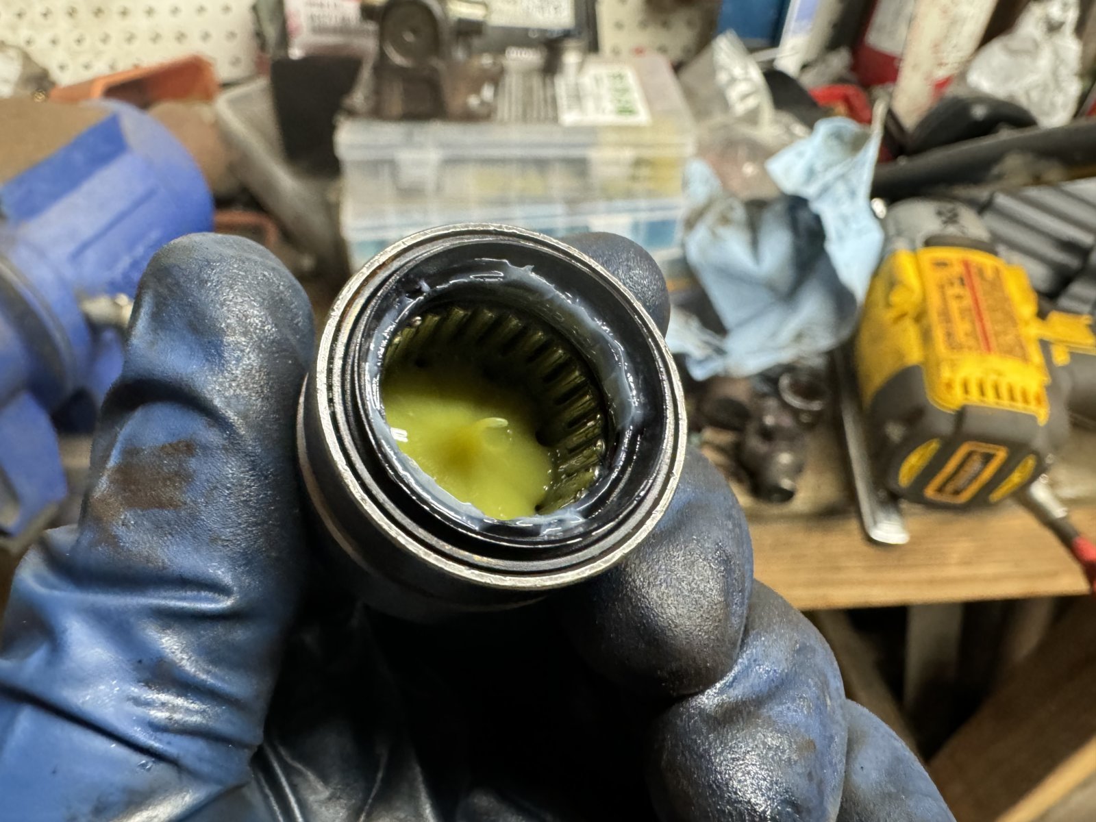

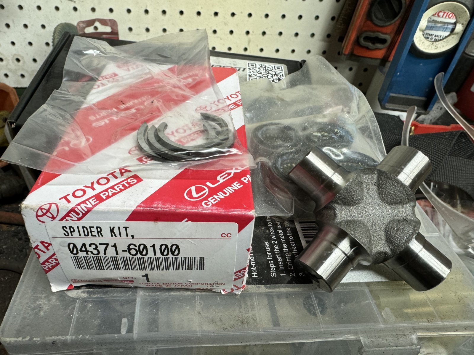

    I’m going to guess Spicer joints aren’t made in Japan. I run spicer 1350’s in my Jeep, and the quality and seals are garbage compared to whoever makes these OEM joints.
    The caps come pre greased with the proper amount of grease. And notice the seal has a different type of grease applied. And this joint was $41 at Toyota. Cheaper than Spicer.
    shifty`[QUOTED] likes this.
