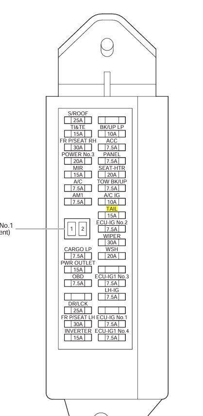

    When mine came up as a Brake system malfuntion, it was the 10 amp fuse under the drivers side. See attachment.
    Hope this helps you.
  10. Jun 17, 2025 at 9:13 PM
    Jodale
    Jodale [OP] New Member
    Jun 16, 2025
    #136600
    5
    2020 Toyota Tundra TRD Pro
    Checked all the regular fuses under the hood and they were fine. Did not know how to check the relays. Have not checked fuses under the dash yet. Managed to stick my head in the rear fender wells but the cables and wheel sensors looked ok from appearance, not able to test them.
