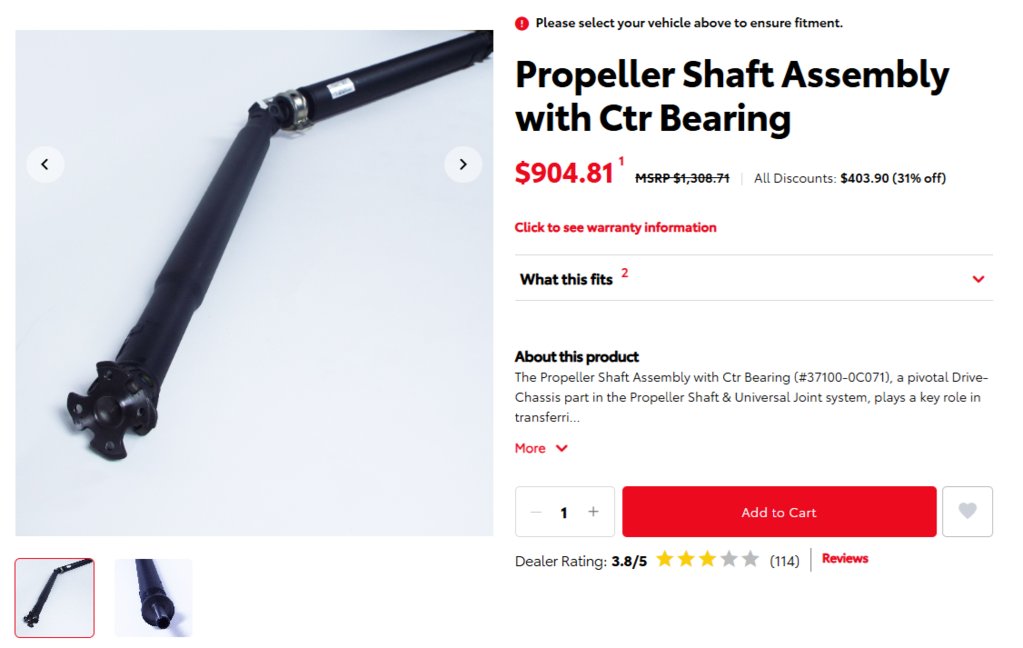

    Well, I guess what I'd tell you, other than "find another driveline shop, because that's not an all-day job", is this.
    I used the sticky thread for parts finding in the EPC. I looked up a random DC that's 2WD for 2006 and pushed its VIN into the EPC.
    It spit out 37100-0C071 as the driveshaft assembly for your truck, and Toyota still makes it (click that link). While it shows up as $1,300 MSRP for a complete end-to-end driveline at that link to the Toyota Parts site, when I chose "shop this dealer" for my nearest participating dealer in the Toyota Parts Program, I see I could technically pick up new OEM if ordering that way for $900.
    That said, if you were to wait for the next parts sale, you could probably pick up the exact same part for as little as $650 (usually you can net 20-25% off w/free ship and such). And if you were to order from HERE, you could get the same shipped, free, and no tax. If it were me, I'd wait, get OEM, and pay the hour for install. But I'd also get a 2nd opinion from another driveline/driveshaft shop, because they should only need to replace for 2WD, what, the center carrier, and 3 u-joints? Dude. 2 hours work, max.

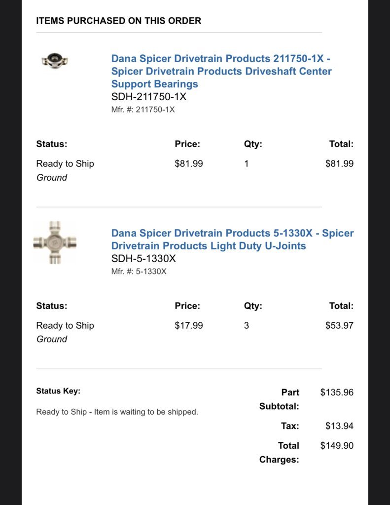

    Here are the part numbers for 2wd (basically oem) I had a driveshaft shop do mine and it was about 250 I don’t remember. But they did everything. They had the truck for about 2 hrs, even drove it to my house to test it. I did have to drive the employee back for me to test it hahaha
    bought from summit racing

    I don't believe that's the correct carrier bearing. It'll technically work for 4WD, but it's not for 2WD nor is it the OEM equivalent, per Spicer.
    I noticed the part number you have is the one Rock Auto will try to feed you if you put the Toyota OEM # into their system, but it's not what Dana/Spicer gives you when you look up the parts in their system. I trust Dana/Spicer over RA any day.
