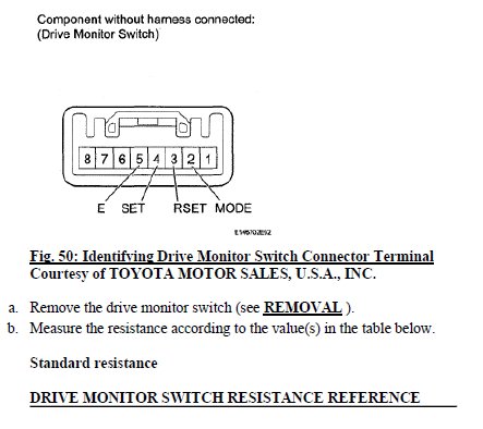

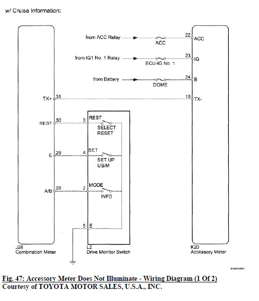

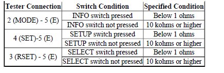

    go ahead an test the drive monitor switch first.
