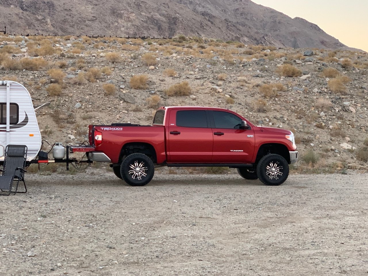

  10. Jul 7, 2021 at 2:41 PM
    jeremyd
    jeremyd 2014 Crewmax SR5
    May 9, 2016
    #3336
    1,469
    NV
    2014 SR5 CM 4X4
    ProComp 7" 35/12.50/18 -11
    Bigboitundra likes this.
  11. Jul 8, 2021 at 6:41 AM
    AlexJet
    AlexJet [OP] New Member
    Sep 30, 2020
    #52986
    115
    2021 TRD Offroad CrewMax
    Good setup. I borrowed exactly the same ball mount from my friend on the last trip. You have it 2" drop position and your Tundra is well lifted. I used it in 3/4" raise position and still was missing about 2-2.5" to have the trailer leveled.
